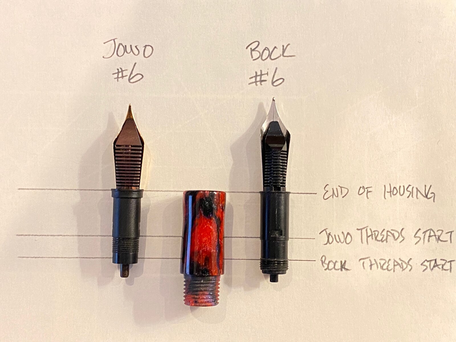

I will share my thoughts from a maker perspective, but will tell you others here have far more experience than I do.
I have the drills and taps for both. I have made sections for both. The biggest issue that I have experienced, and have read about (and listed about on the "As the Pen Turns" podcast), is that the with the Bock #6, the drill hole/tap/threads are slightly larger and they are farther back on the nib housing. This means that they are deeper into the section, and closer to the section tenon, which translates into a thinner material near the section tenon and increases the probability of breaking the section during making or after.
Here is a quick photo I took of both nibs and a section. You can see how much closer the threads on the Bock are to the section tenon, it definitely creates a week spot and I have had them fail as I am making them far more frequently that with making Jowo sections.
I hope that this makes sense. Let me know if it does not.

d_bondi - great pic and explanation. Also a big fan of 'As The Pen Turns' here. I think the thickness of the upper seating lip and the general diameter of the Jowo also can be problematic, but it is true the deeper set-in of the Bock threads gets things a might bit tricky when doing the section. As the guys on the ATPT podcast say - it will break when all you have left is one last little piece of a custom blank remaining!

Great graphic David, very helpful. There is a Bock distributor here in the U.S. (maybe more than one)but the one I'm aware of sells them and tunes them for free. Bocks are a tad less expensive I think overall, come in a few platings that Jowo's do not. I find that from time to time certain size Jowo#6 are challenging to get hold of, esp when the pen shows are in full swing. I'm not sure about Bocks as I am just getting ready to venture into Bocks.

As noted above, be a bit more careful with making the section for the Bock, they are a bit tricker and easier to break.
Don't ask me how I know. :cool:

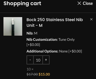

No, Meister Nibs only sells Jowo. Pen Realm has a very similar program for Bock. Just to check I added 9 nibs to my cart at PR and there was no discount applied.
@hertzogcraig - if you want to get some inexpensive nibs to work with look at osprey, i have found them to be good but a little inconsistent (stay away from the clear housings though)
Here is a snapshot of my cart at PenRealm with 10 Bock nibs, and the discount shows. Not sure why I was thinking it was at 8. Sorry about that.
