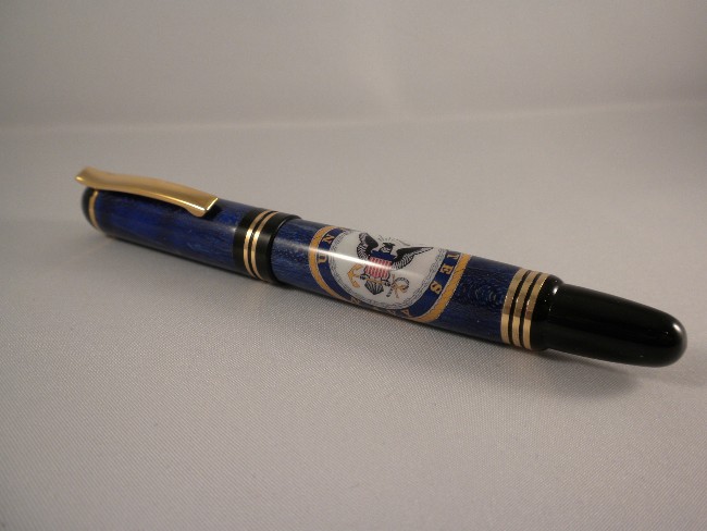

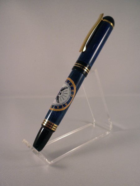

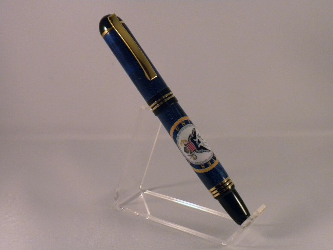

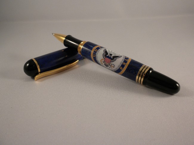

Here's one I made for a friend of my wife. Her husband was retired from the Navy. It's not a Dymalux blank it's maple dyed blue and the logo was a decal I made.

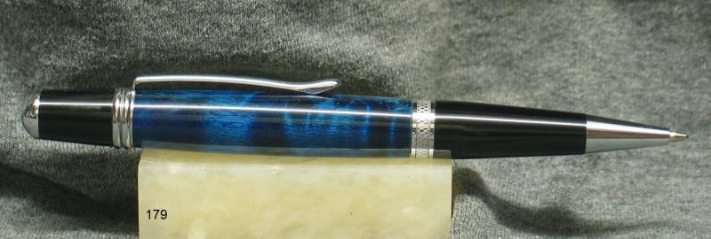

Check out the dyed maple at lazerlinez I have turned Constants wood and it has a good color all the way through

Very nice. How do you make a decal?
Thanks for all the suggestions.
Mike[/QUOTE]
I found the picture on line and saved it. A little trial and error resizing and then I printed it out on Testors decal paper using my HP ink jet printer. Spray it with a sealer then I cut it out. I turned my pen body to finished size and gave it several coats of thin ca to seal it and let it dry over night. Next day I set the decal and let it dry for another day then I covered it with 8 coats of thick ca, mm'd and polished.
