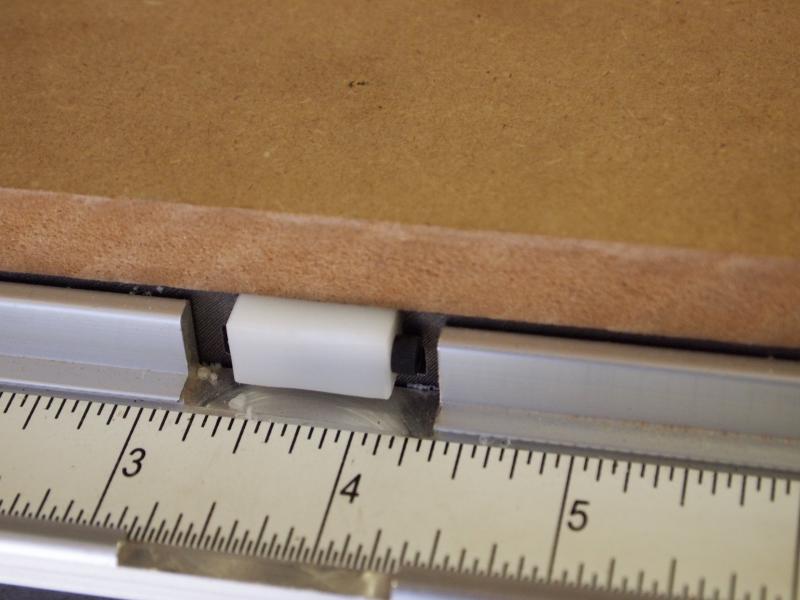

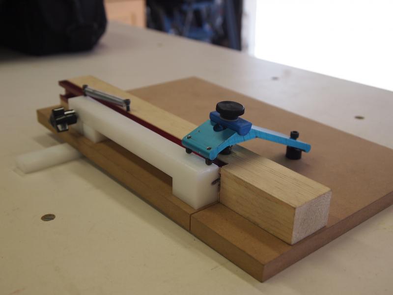

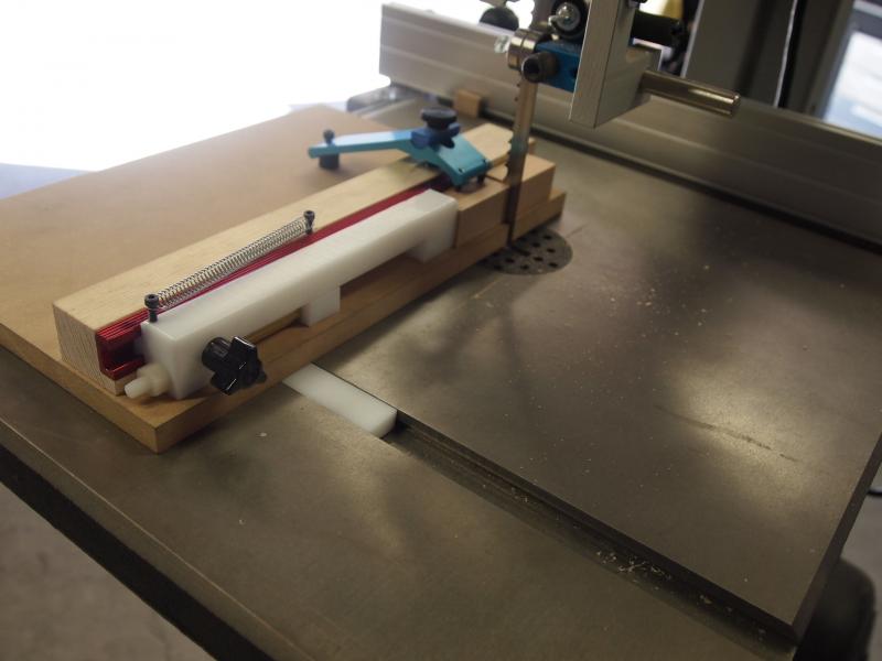

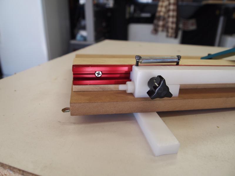

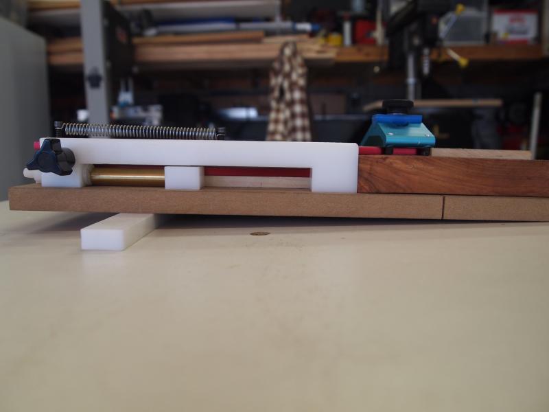

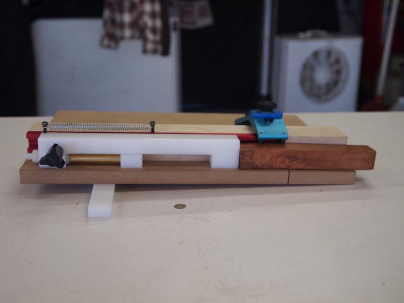

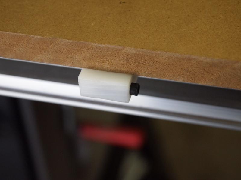

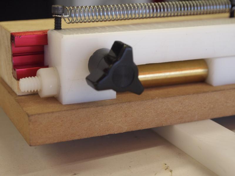

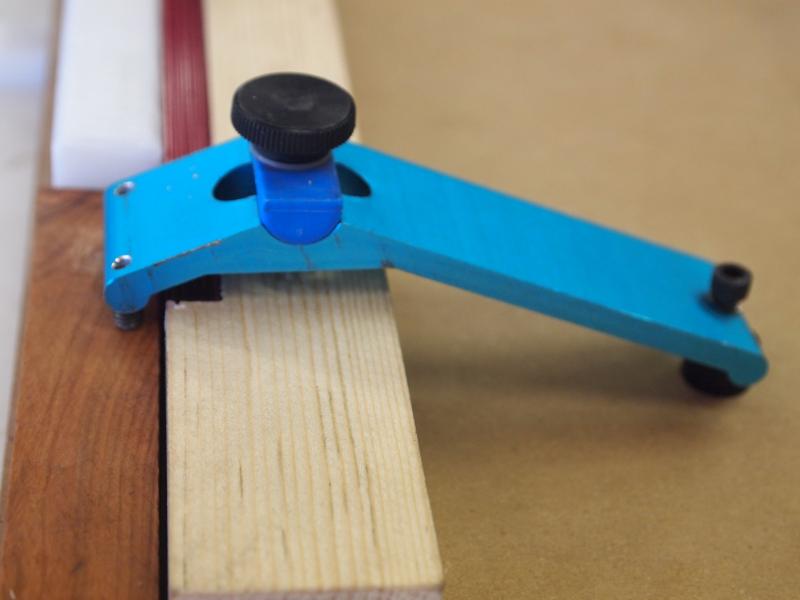

I started to make a blank cutting sled like the one I saw in another post here last year, well I decide to improve on it a little (well my version of improve)
I made the sled to have the sliding stop attached to the sled, I also added a lock screw and made the stop adjustable so I could make the blank's longer if I wanted to. (it can adjust from .032 longer to .312 longer then the tube)
I also wanted a different type of clamp so it was a little lower profile.
I also put a stop on the slot bar so the sled would stop and not cut too deep into the sled
See the pictures below for my version.
Comments and suggestions always welcome. :smile-big:
Thanks
Danny

Danny; I like the spring loaded idea as it eliminates the need for a clamp. The threaded adjustment is a great idea too!
I would try to rotate the jig 90 degrees so the brass tube is visible from the top and front of the jig. This is just a sight or visual cue though.
