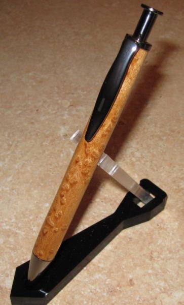

Nice piece of Birdseye Maple matched with a contrasting black Titanium clicker pen.
yorkie Member Joined Mar 2, 2009 Messages 1,116 Location Charlotte, North Carolina Sep 18, 2010 #1 Nice piece of Birdseye Maple matched with a contrasting black Titanium clicker pen. Attachments IMG_5715.jpg 27.5 KB · Views: 249

T TRRH Member Joined Apr 5, 2010 Messages 21 Location Fredericton, NB Canada Sep 18, 2010 #3 Very Nice-- I have lots of Bird's Eye Maple: Did you use BLO (boiled Linseed oil) etc. to enhance the grain... or CA which some say will do the same? cheers, Terry

yorkie Member Joined Mar 2, 2009 Messages 1,116 Location Charlotte, North Carolina Sep 21, 2010 #8 I use BLO to enhance the grain and not sparingly. I then spin the lathe to really seal it into the wood and let it sit for a while. I then finish with several coats of string instrument grade lacquer.
