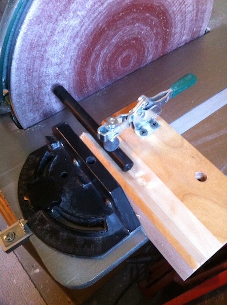

We use a disc sander with a transfer punch in a wood V block attached to the miter gauge.
If you don't have a disc sander then I would recommend getting one of the sanding gizmos Rick makes to fit in a tailstock drill chuck.

I use a method similar to the disc sander method above. I made a makeshift disc sander for my lathe by screwing a piece of plywood do one of the faceplates and mounting that to the headstock. I stick an adhesive-backed 80 grit sanding disc to the plywood. In the tailstock I use the appropriately sized transfer punch, held in place by Rick Herrell's (rherrell) offset sanding jig, made for the purpose. The jig is chucked into a drill chuck mounted in the tailstock. I learned about this setup in the forums, though I can't remember where.
If you have a lathe, you already have everything you need except a piece of plywood, an abrasive disc, a set of transfer punches, and Rick's jig. You can get all that for a combined $45-50, maybe less. If I were starting over today, it's absolutely the first thing I would splurge on.
