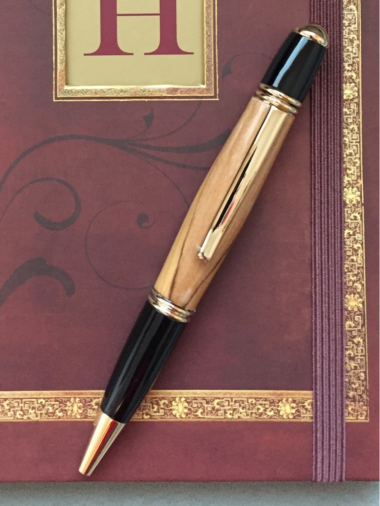

I second the Sierra/Gatsby style kits. Single turning per pen and makes a quality pen.
The pen kits look like this and they run about $6 a kit. Other advantage is they only take half a blank so 2 pens for 1 blank.
Slimlines are more also more difficult to make.
