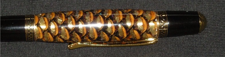

Depends on the resin color I suppose, mine was cast in red so I used light grey. Other than the "UGLY PEN WINNING" factor it looked great as far as the color went.

Neil cast these cones in clear for me, Landon, so tube visibility comes in loud and clear...
That being the case I'd guess a "lighter" brownish color to match/simulate the core of the cone. My opinion of course, remember mine was deemed "BUTT UGLY" :beat-up: Of course the awesome blank had very little (if any) to do with that award.

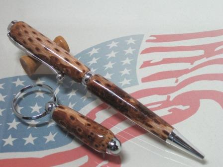

Apparently I`m using a different Pine Cone than what you have. The few that I have turned you can`t see the tube. This is the last one I turned it`s a slimline. It was turned from the core of a Long Leaf Pine it took two cone to make one pen. It is not cast just soaked in CA a couple of times during the turning process. Point is it didn`t matter what color tube that I used.
