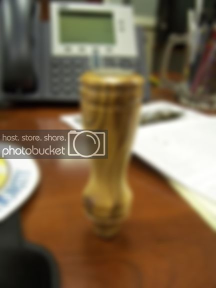

I shot you a PM. I'm gonna wright a 'how-to' for them soon:

Thanks for the PM and the photos. I too look forward to your tutorial. I always love when people take time to show and explain a turning process. That is a very nice turning and the wood is beautiful. If this person wants me to go htough with this project I will post a photo when done. He has to get me the thread size.

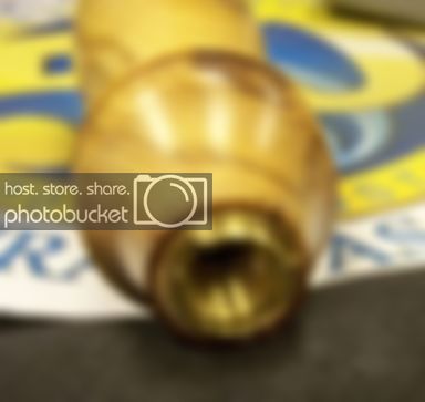

I turned an acrylic one and used my same inserts. The key is, take it to the grinder and grind off the outer thread of the insert. It fit right inside the 1/2" drilled hole, just threw some CA in there and I was in bitness. (werd.)
