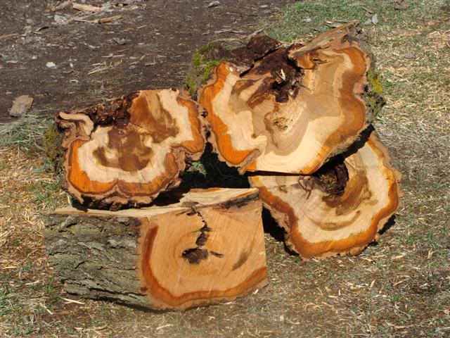

A friend in town asked if I wanted to cut an old apricot stump down for him in exchange for the firewood. It was green wood full of sap yet but hollow and decayed in the center. It is such pretty wood so I sorted out these few pieces that I thought might have possibilities as turning wood.
Then I started dissecting it with the chain saw working around the hollow center and came up with eight pieces of beautifully colored solid pieces about 16" long each.

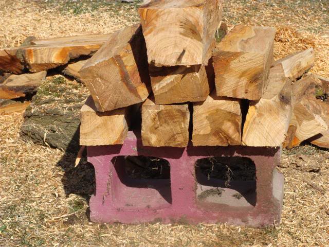

Will anchorseal both ends today and store them between stickers in the garage until they are dry enough to make all kinds of turnings.

Apricot is a wonderful wood to turn, very unique colors. It is also very difficult to dry without twisting and splitting. I would cut the blanks over-sized and coat the ends up about 1 inch with Anchor seal and let them AIR DRY!! If you hurry the process, expect to loose 50 to 75% of them

As David said, I would also cover a great deal of the wood with anchor seal, or whatever you coat with, and probably be longer than a year before you can turn it. The wood is pretty as heck, but it is difficult to keep from twisting and splitting. Almost total coverage is needed to reduce the chance of this happeneing, I also agree that it would be a shame to use this for blanks only. Thanks, cause YOU can make some real nice things from this.

Yes, I agree David.
Any of the fruit bearing orchard woods can be a challenge but after many years of using different kinds of them I am having a lot better sucess rate.
I just got a bunch of orchard cherry wood cut and sealed and put away about ten days ago . I don't think I posted that on this site because at that time this site would not remember my log on info but now it does. .
I am also doing a almost day to day comparison and experiment on my own site with both a boiled and a DNA treated bowl from it. I have a lot of experience with DNA for having green wood ready for final bowl turning with a couple weeks but none with boiling so I was asked to do the comparison for some where DNA is not available to them.
