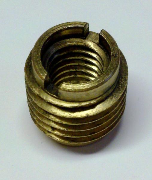

threaded insert
I have used a threaded insert that will accept a 3/8-16 bolt like on taps for a couple of handles made in the past. Available even at your local big box hardware store.

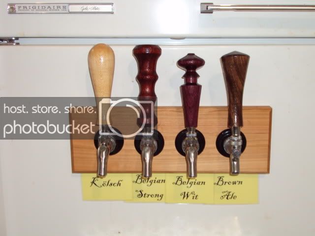

I did a run of a dozen or so for a brewery last fall. They specified they wanted a steel shank reinforcing the tap handle. I used 3/8 by 16 stainless all thread about 8 inches long with the end of the all thread to fit standard ferrules.
Started with 3 by 3 by 14 inch blanks between centers, and turned a tenon for mounting in a chuck. Then mounted in the chuck and drilled for reinforcement rod. Used a ferrule and Nova Tailstock on the outboard end and chuck on the headstock end.
Engraving done by Ken Nelson
