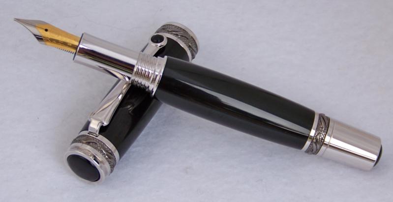

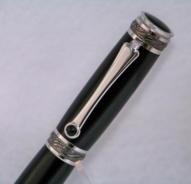

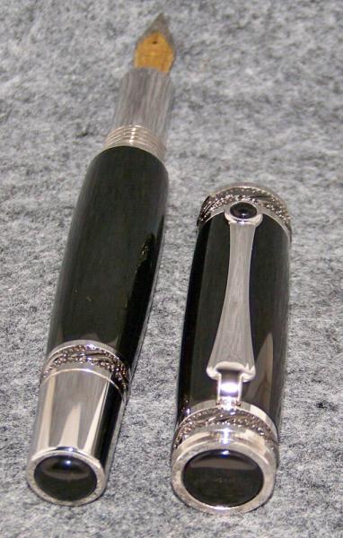

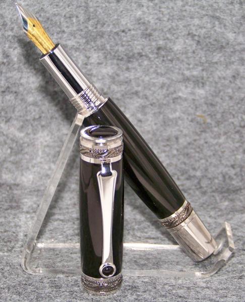

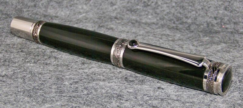

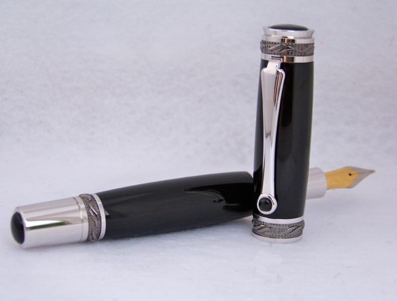

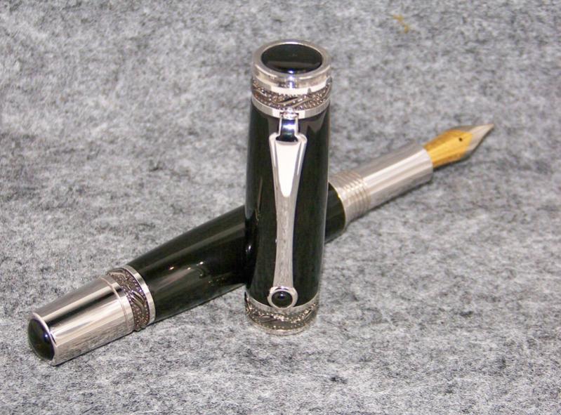

This is a pen I've had in my mind to make for quite some time now. I can't stand the pimp crystal on this kit so I got rid of it and made it one cool cat instead. While I was at it and knocked out both finials and turned my own. The blank is a black onyx truestone from R&B Crafts. I was able to squeeze everything into 1 blank. It was alot of tedious work and I think I ran the batteries dead in my digital calipers making sure I had everything perfect. I had a blast making this pen and I can't wait to do another (already got the pimp crystal out!) All parts were MM to 12000, Buffed with Tripoli and White Diamond, and polished with PlastX. I made this pen as a special gift for the Pastor who will be officiating my wedding on the 22nd. I have a hunch that he will appreciate it greatly. Thanks for looking and as always any comments/critiques/questions appreciated! Also, all the little white dots on some of the pics are reflections...I'll try to take some more pics in the morning in the daylight. Who knows....maybe this one will grace the front page :confused:

Wow, that is really nice! It probably would have been cool by just removing the pimp crystal, but getting adding your own finials as well is well...uber cool! Great job!

Turning the finial and the replacement piece for the clip really brings the pen together. Very good job. Mike

I gotta agree, great improvement over the stock kit, and you nailed the execution on all of it. The curve of the barrel blank looks to match the angle of the bottom cap perfectly, yet does not look out of place with the almost straight top, and that's a tough match to make. My only question, did you intentionally reduce the radii of the cap finial more than the bottom one, or were you running short of blank? Or is that a photographic effect?
Thanks! All the cuts were intentional. I did almost run out of blank, but I made it exactly how I imagined it. With the replaced crystal having a more round shape I wanted to compliment that by keeping the same shape on the bottom finial. With the cap finial I wanted to keep it closer to the curve of the barrels. I didn't want to have the clip accent looking out of place by being a bit bulgy by itself.

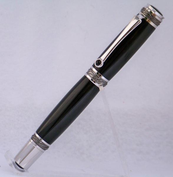

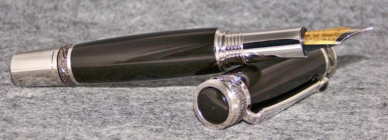

Took some more pics just now outside, I think they look a bit better on a white background.
