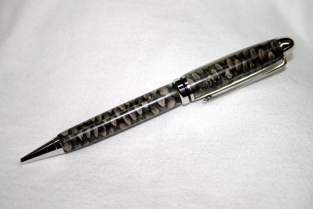

On some of my pens the seam is more obvious than others. The blanks I have received from AS have so far been the best at seams being blended in.
<br />
If you look close you can see the seam. This was not purchased from AZ but the seam did not interfear with it being sold.

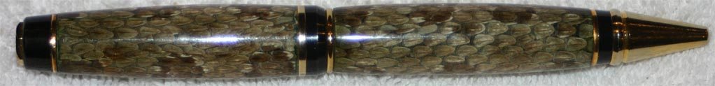

I've shown a cigar pen to show the seam in just the past few days. There is a thread on just this topic. The skins are cut and wrapped around the tube and overlapped just a little. The seam is almost invisible when you learn how to do it. There have been two or three good snake skin threads in the last week or two. The most rescent is entitled "discoloration when castintg..." and here's the link:
http://www.penturners.org/forum/topic.asp?TOPIC_ID=11631
And here is the picture of the cigar seam side. Where's Waldo...I mean Seamo [:D]

Yeah, that cigar, I can baaaaaarely see the seam, geat job!
I imagine if you can manage to cut the overlapping edge at an extreme inward angle, the 'skin' below the scales may not show. Cant wait to try , gonna be a little while though.

Thanks and I think you just figured out the seam secret. [;)]
