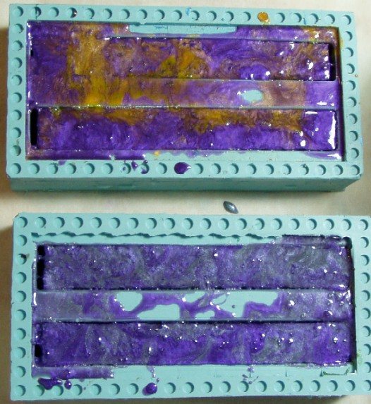

As my old high school colors were Purple and Gold, and Kris was interrested in Purple and Grey, I whipped up a batch of Purple and a little batch of Pearl Grey and a little batch of Gold and had a Purple pour.

If I may ask, what did you use for the purple.
If the pictures are accurate that's about what
I've been looking for. Mine so far have been
too lavender.
Regardless, those look sweet.
Thanks

I'll give you a hint, but only if you all can keep a secret...;)
I start by mixing a base color with liquid dyes. In this case Blue liquid dye(from US. Composites) and Orange liquid dye(from Surfsource.net), till I achieve a transluscent or semi-opaque Plum base. Then I added Pearl-Ex #644 Reflex Violet.
All my colors are combinations of liquid dyes for base components and then Pearl-Ex to fill out or alter the color with pure pigments, metalics, pearls and interference colors.

The colored pearl-ex must be the key.
I've been using ArtStuf dyes, and the purple and violet
dyes are good, but when I drop in pearl white it goes
too lavender.
I've just gotten some ArtStuf violet luster pigment and
some pearl ex, so I'm going to have to try another batch.

Why are you adding Pearl White if you are trying to get purple or violet? Purple + White = Lavender, or in this case Lavender Pearl. You should be adding either Micropearl or Macropearl, they don't contain any pigment, they are just pearlescents.

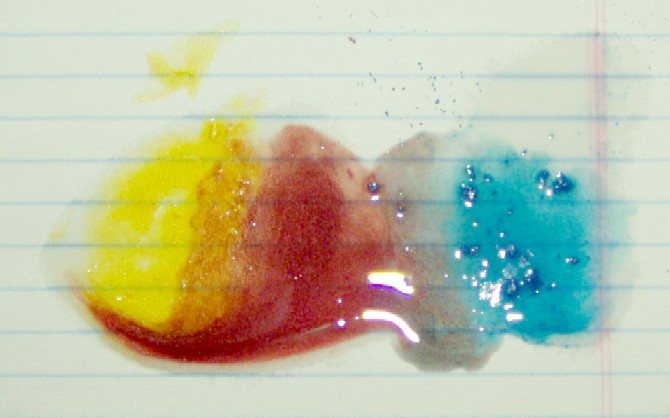

On the technical side... Some people are casting by the seat of their pants. Some people are meticulously analytical about casting and record every casting. I set up a spreadsheet to record my progress. I have sometimes printed a blank form and just started writing what I want to attempt using my notes from previous casts and make notes based on the out-comes.
This was just a down and dirty what do they look like test, but one can expound on it and make some color cards. I just took an exacto blade to pick up some Pearl-ex and dropped it on a note pad then using some cheap dollar store CA glue dripped it on, then using a HDPE dowel I had laying on my table, started to mix at the interfaces to see what colors I got from mixing or overlapping the Pearl-ex pigments. I apologise for it not being the best of pictures.
