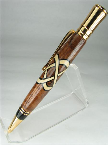

I have a friend who is a master at making Celtic Knots, at least in my opinion. We did some trading and I received this Knot.
It fascinated me when I turned it to see the knot appear. I like the length of the blank (2⅞") on the PSI Executive. It's finished with BLO/CA.

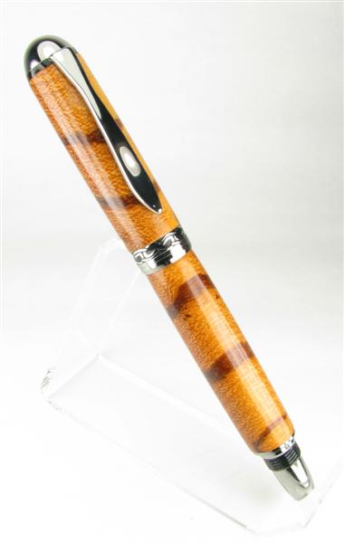

And now that I've got you here, here's a Sedona RB pen made from some of that Marblewood you so graciously sent to me some time ago.
Of course, you can tell the Marblewood has been X-cut. I'm kind of stuck in the moment of turning X-cut woods. It adds a new challenge to pen turning.

You and I each made the same mistake on the centerband of the Sedona. The small silver ring goes on top of the scalloped piece, at least according to the instructions. It dawned on me that I was making this mistake as I was pressing the pieces together.
Nice pens at any rate.
Very nice!
Celtic knots are fun to make.. Been making some on keychains and stuff.. seems to be popular.
Hi Keith; I have 4 other Sedonas in my inventory, all done correctly.
This one is out for laser engraving for a pen swap I'm in. No chance of correcting the centre band now, unless someone has some ideas to pass on.
That's a mistake that won't happen again!

Lucky guy Mark! That is a beautiful pen. Would you provide a few details- How many knots are on the pen? Could you measure the width of the knot? It looks like it is the width of a thin kerf blade.

Lucky guy Mark!
Hi Todd; Actually my name is Mack.:)
There are 4 knots.
That's somewhat difficult, since because of the turning, the knots are different widths at different points.
I recall Larry mentioning a thin-kerf blade.
Here's his tutorial that he has posted on a Canadian penturning site. I'm certain he would have no objection to you using it. He is a member of IAP (Larry from Harrow) if you wanted to be in touch with him.
Knots like that one are 4 sided and cut with a blade 3/32" thin kerf. I happen to use an 80 tooth blade for smooth edges. That knot shown was cut either at 60 degrees or 65 degrees. I know Larry was talking about experimenting with 65 degrees. Here is one I did not long ago based on the same principle. As you see there are factors to the final look. The red was put on a Sierra kit and the yellow was put on a Sierra Vista kit which is abit larger and makes the knot stretched out more. Hope this helps.
