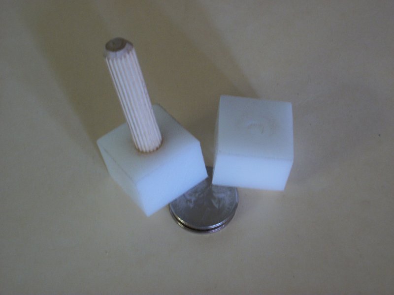

I turned a 1/2" dia shank on a UHMW plastic puck to fit my drill press. I had the material and I'm a brand new turner (like shiny penny new), so I figured I could use the practice. Overall it's about 2" across and is slightly concave on the bottom. I reasoned that it would help self center the pens. Maybe, maybe not, but it works.
I've assembled three pens for myself and two that my son has made and it seems to fit the bill.

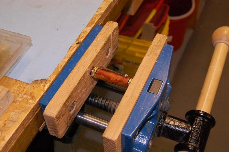

Well, this little thing has been working good for my pen assembly vise. Not very portable, but it sure works great!
  • Quick release screw for fast setting
  • wood jaws prevent damage to pen parts
  • and fine control over how much pressure is applied
  • :wink:
  • :wink:
Always look for the multi-use tool! I too use a woodworkers vise to press pen parts in. Quick release adjustment. It has wooden jaws with magnets to hold jaws in place. Markings on the jaws for alignment.
