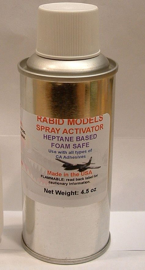

I bought this a while back.

Well I bought both my ca and accelerator from the same place, rabid models. The can really doesn' have a brand name on it, just the sellers name. The ca I'm using is Robs R/C hobbies.
