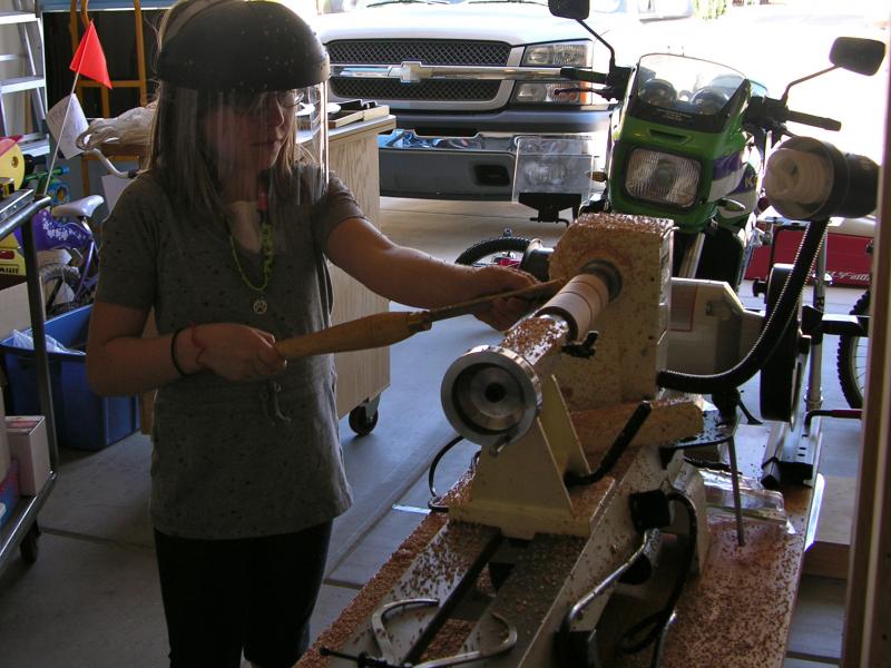

Hey Guys,
This is my daughter Grace. She is 8 years old, and this is her making her first chips fly. We owe a lot of thanks to a lot of people for helping make this happen.
Dwayne of Woodcraft in Chandler, AZ for the tools, information, and a bunch of helpful advice. Buzzzz4 for sending her some nice blanks, kits, and a pen she loves. Also, Airrat and Jmhoff10500 for sending us some nice blanks. Thanks to all of you that made this happen. I am sure she will enjoy this for years to come.
I know I enjoy the time we spend in the shop together.

Wow, that's great so see...!
While it seems that she is doing well, I would suggest you to make her a stand about 4" tall where she can stand on as her right hand/harm is too low, making the gouge angle to be a lot more acute than it should as this would also minimize the possible catches the tool angle will provoke, probably scaring her from turning...!
From what I can see from the pic, the 4" should be ideal, I have no doubt that she will grow those 4" quicker than what you would like but at the moment, it would help her...!:wink::biggrin:

I have 3 daughters and only one turns but it is a very special time for us. So enjoy it as long as you can. A little stair stepper will bring her up those four inches. That is what my daughter uses. We also used them at the woodworking show when I help at the Craft Supply area for adults and kids to turn pens.

Thanks for the advice on raising her up. I knew I needed her higher, but I wasn't sure how much. I was told once that you want the center of the spindle even with your elbow at the bend. Is that true?

Well that can be truth to a lot of people but the length of the right arm for right ended persons, can make a difference also. In general, the hand holding the gouge should be as perpendicular as possible to the spindle center, this does reduce the strain and gives a more balanced movement to the cutting tool.
This is not, one size fits all but, it does give a starting point...!
