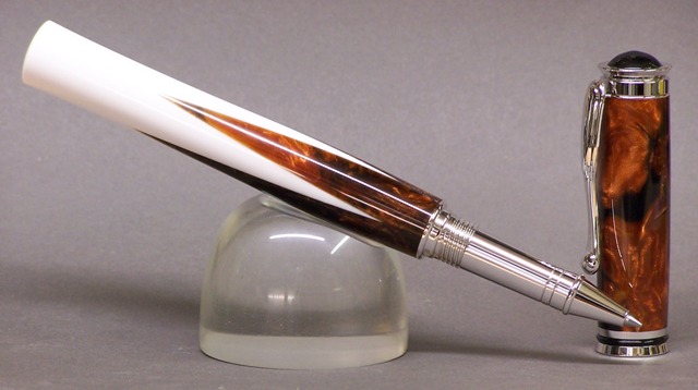

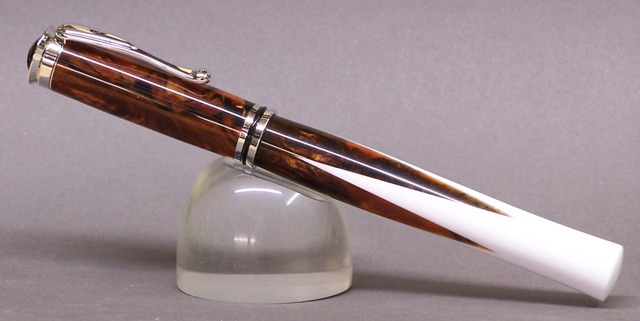

I have a buddy in USA that is a 'Mafia Don' ( well he likes to think he is ):biggrin:. This is for him.
Some segmented Burnt Copper and Pure White pr from the Princess ( of course :wink: ) Closed ended on a Jr Retro. I kinda like it, but it was a bit tricky to do the segmenting with a router.
Critiques or comments welcome.:wink:

gvanweerd
Oct 25, 2009
403
Kuna IDaho
I love it!! Way to go! I've been wanting to do something like that for my pool playing buddys. but i haven't figured how to make the segment as of yet. jealously i say GOODJOB!

You never fail to come up with outstanding pens but Skippy,Skippy,Skippy you know there's no such thing as the "Mafia" just a bunch of eyetalins that like to hang out eat pasta and own strip clubs .

LOL, I dunno about that!!! This guy has his own personal hit man with missing digits:biggrin::eek::wink:

Beautiful work, Skip

That's outstanding Steve! I love the segmentation work and the sharp clash of colors are a major compliment. I know this guy Mafia Don too. He's really high ranking in the world of illegal Black Jack back behind the Ole Spagetti Factory.:biggrin: His Dealer..oops, I mean hitman, is also the garlic chopper. Don likes his garlic sliced super thin so it melts in the pot.

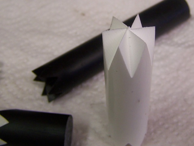

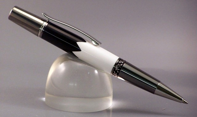

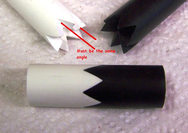

Perhaps Jeff was thinking of this one? This was a real pig to setup and I wasted tons of pr blanks before the penny dropped:mad:
But now with the setup on my drillpress / compound table, I find the flexibility almost limitless.
The cuts in the second pic are correct but the ones in the third pic are what I was convinced that they should look like. The router bit used here was a 60deg (included) perfect point bit.
I don't believe that it's possible to do 'long' angles and still only used two parts. Beyond me anyway:biggrin:

Well today I was blessed with this Skiprat original and officially deemed him my #1 CAPO (Crazy A$$ed Pen Oracle).
Until you hold one of his pens in your hands you really don't and can't appreciate his workmanship. Thank you my friend!
