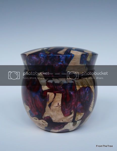

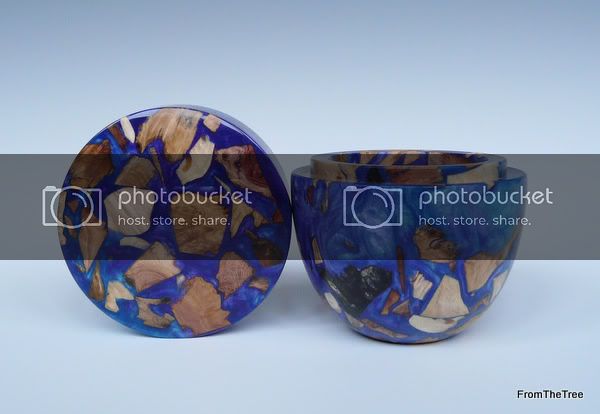

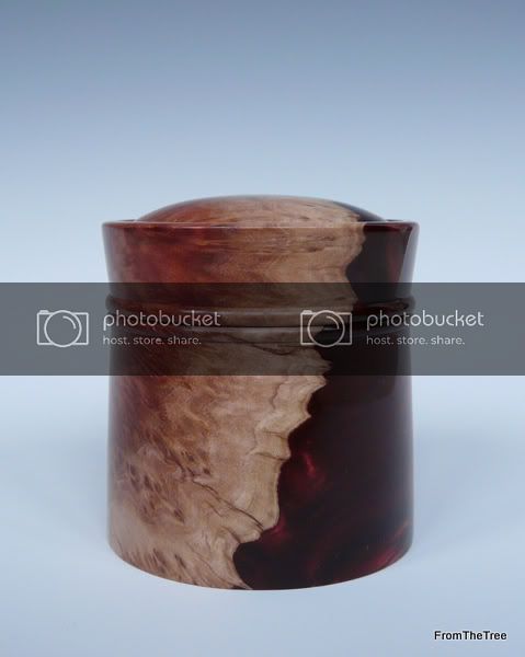

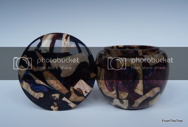

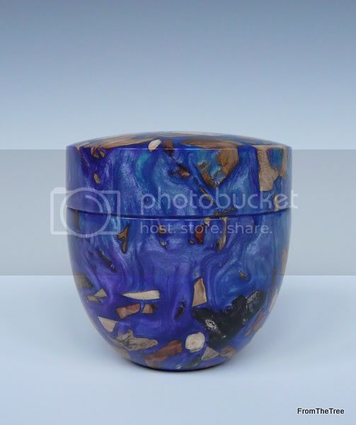

I've gone all "Amalgam mutty" just lately and have turned 15 box's here's a few of them
there will be an article in a future edition of Woodturning design on how i make these, for those of you who fancy having a go. I'm not sure which issue yet but its all done from my end and in the hands of the editorial team now.
A Jigsaw with red/purple blue resin
Burl bits in cancun colours- how may types of burl can you spot?
ozzy burl
