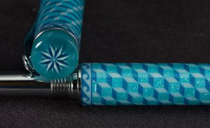

So here's the story behind my 9D pen that I entered in the Advanced Beautiful Pen contest. It was a 3D illusion executed in 3D. I suppose that could make it 6D pen, but 9D sounds better.

The pen is made from PR and it took 4 casts to complete it. The process is similar to other pens I've shown over the last year.
Cast white resin blank, turn to shape, carve, cast aquamarine transparent, turn to shape, carve, cast blue transparent, turn to shape, cast clear, turn to final shape and polish.....at least I think that's what I did. I used pearl effects in the resin to give it a shimmer. Here's a closeup.
Some of you may be thinking that this might have been Escher inspired. While I love the work of Escher and hope to someday do an original pen that would be inspired by his work, he was not the inspiration for the design. Years ago I saw some ancient greek mosaics (about 1100 BC) in the Pergamon museum (in what was then East Berlin). My memories of those mosaics were the true inspiration for what I pulled together here.
Except for the design on the cap finial. That's not something the ancient Greeks would recognize. However, any sailor worth his salt should recognize the design on the cap finial as a compass rose. So a compass rose that might have been found on a sailing vessel in the 1700s combined with a 3D illusion inspired by ancient greek mosaics. Since the ancient greeks didn't have pens, I guess I can be allowed a little artistic freedom in selecting my design elements for the pen.

This one was a winner the moment I saw it. And please - no need to get better next year:) Have some pity on the rest of us mortals. Looking forward to your Escher. I did one a while ago and thought it was pretty cool.

Amazing effect, Ed!!
After reading the process, I can only say you have great patience!! And the final pen is your reward---Gonna do a couple a day now???:biggrin::biggrin::biggrin:
GREAT result!!!

Here is an example of a pen that I am sure will not be copied by us, not sure about any big manufactorer. Job well done and thanks for posting and congrads on the winner. Love the colors.

You have made one FANTASTIC pen. The more I look at it the more I like it. Thank you for giving us a little info. on how you did it. I know for sure I will not be making one, I will just look at your's. Thanks

If you don't mind answering, how long did each of the carving runs take?
Hi Rich - Setup time takes about 15 minutes. There is absolutely no room for error here. The pen moves between the DOL, metal lathe and wood lathe multiple times as I complete the various operations. When I return it to the DOL, if I'm off by even 0.001" in the linear or 0.01 degrees in the rotary, the pattern will be ruined. The various carvings take between 30 minutes and an hour. Total time (not counting setup) for all carving on the cap and body was about 4 hours over the course of a week.

Is it safe to assume that you carved it all by hand just as the ancient Greeks would have?
Would you be willing to disclose what you are using to carve it if you are not emulating the ancient Greeks?
Interesting question. Having thought long and hard, I would say that I did it the way the ancient Greeks would do it if they were doing it today. But more importantly, I think I can honestly say I did in fact do it the way the ancient Greeks did it.
The ancient Greeks couldn't just nip off to the tool store to buy tools to do whatever needed doing. Artists and craftsmen made their own tools to a large degree. This is what I did. The only difference is that the materials available to make tools these days are somewhat more powerful than what was available a couple thousand years ago.
If you review some of my posts from April / May last year, you will find discussions and pictures of the DOL I built.

Hi Ed - A couple a day? The next one would probably go a little smoother than the last one, but it's still about a week of work.
What I really enjoy is learning and trying new things. There are so many things I want to explore and try that it is really hard to force myself to repeat.

When I'm carving large woodturnings (up to 14" diameter (355mm)) I leave the piece in the chuck as I move back and forth between the DOL and the wood lathe (which have the same spindle thread).
When the metal lathe is added to the arsenal I can't move the chuck because the metal lathe has a different mount.
For small turnings, especially pens, I use collet chucks instead of scroll chucks. I find having a collet chuck on each tool and just moving the work is a better solution.
Ed

Hi Mike - DOL = Digital Ornamental Lathe. It's what I call the tool I built to carve on my turnings. If you search the forums (SOYP) for DOL you'll find posts of mine from 2012 (April / May I think) where I posted pictures and talked about it.
