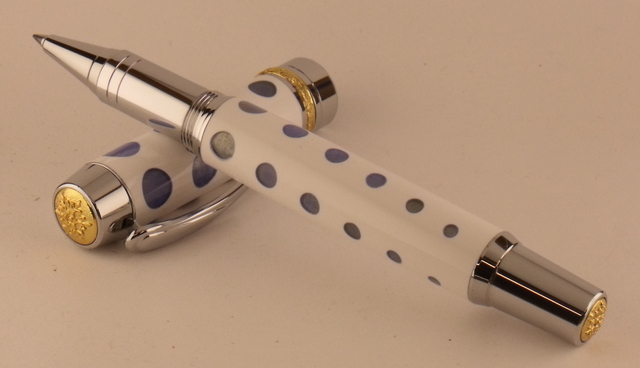

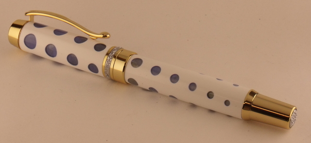

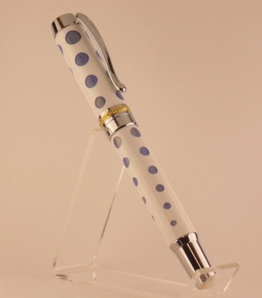

This was just a quick bit of fun really, but the blue dots are a bit wishy washy and the tube can be seen through a couple of them as they are so thin. I also changed the kit to see if a gold one would look better. Not sure either way.

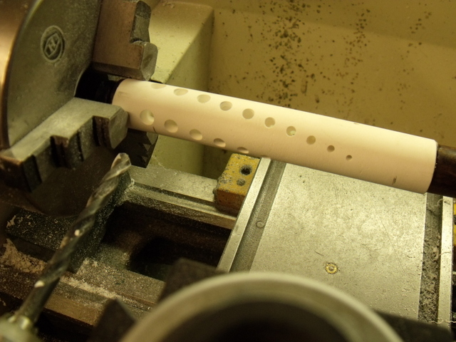

Nothing fancy, but it was an exercise in index drilling using the lathe headstock main gear as the index (40 teeth )
The dots reduce in size by 0.5mm but the gap between the dots remains the same.
I made this while giving my fingers a break from sanding down the steel WTC pen. :biggrin:
Thanks for lookin':wink:

I thought I would like the chrome colored hardware better but he gold also looks great. I guess you have made one that is kit color insensitive. Looks great either way. Nice pen.
Awesome, love the spiral look :biggrin: and it appears you have lined up the cap and body very well.
Awesome pen. I like the kit.What's it called ?,and where can you get them?
It appears to be a Pristina, you can get them from Timberbits. Not sure if any vendors here have them.
Pen Making :: Rollerball and Fountain Pen Kits :: Pristina Pen Kits - Pen Kits, Pen blanks, Clock Kits and wood turning accessories.
Really nice pen.
You can get the Pristina RB and FB from Classic Nib.
CLASSIC NIB - TIMBERBITS FOUNTAIN AND ROLLER BALL
