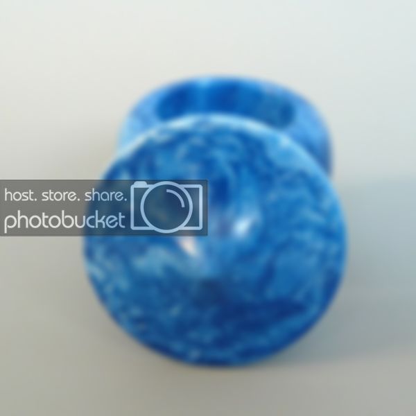

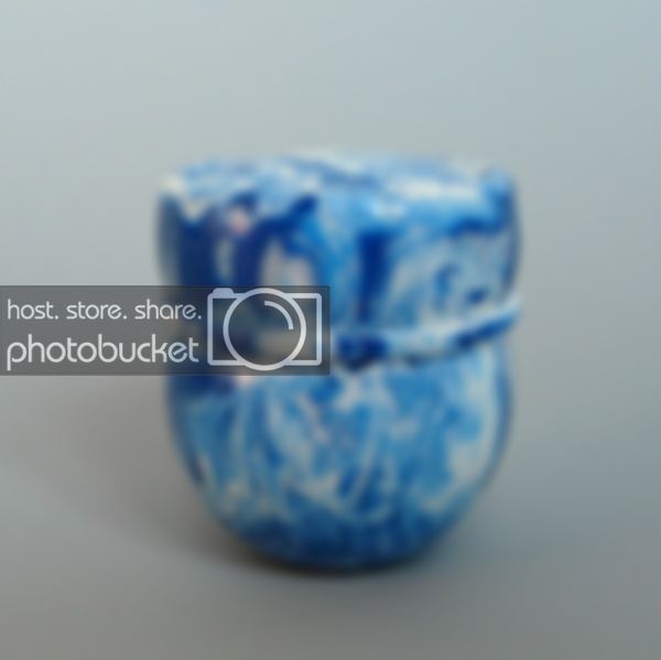

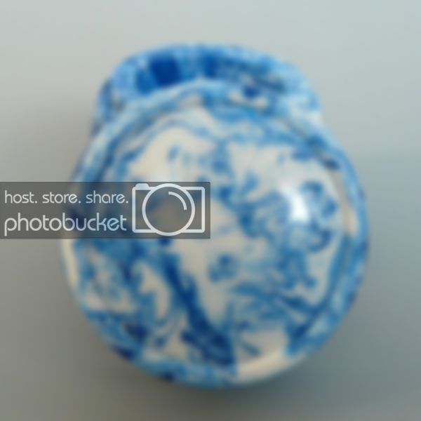

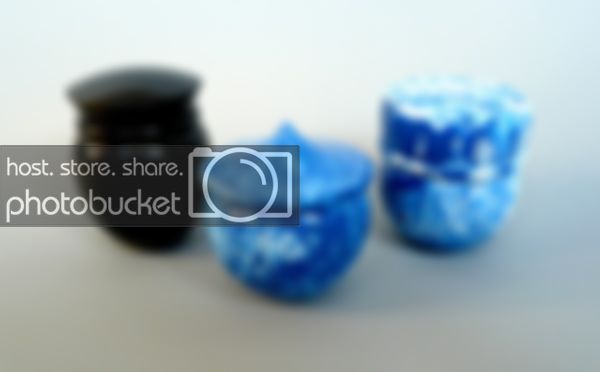

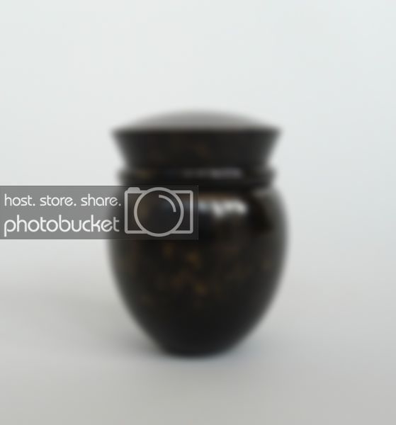

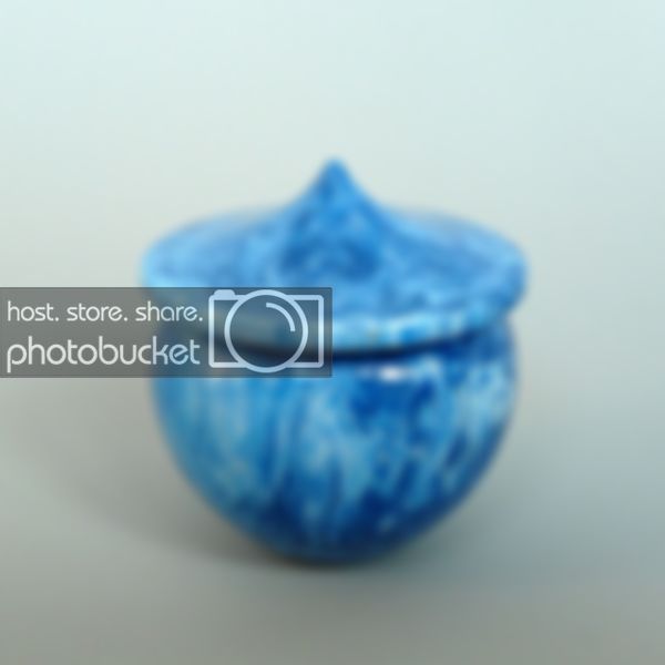

hello folks here are 3 new box's that i've turned today- i've struggled a little bit photographing these but i hope you get the idea of the shape and markings etc
these are all polyester resin- two are a blue and white swirl and the black one has some gold pearlex in it which looks great in the sun light.
they are all around 2" wide and between 1 3/4" and 2 1/4" tall

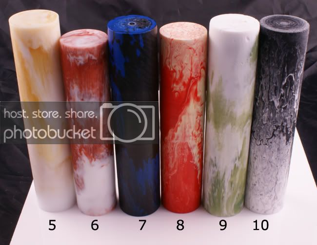

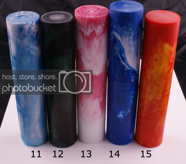

Hi George, as I said before mate very nice work, just to give the guys an idea these are just some of the large blanks (50mm x 6") that I cast for George, actually George it seems that people do like the darker one the best (black and gold) as a tester mate why don't I make you a black mint one too FREE OF COURSE. See how it turns out.
Well done mate! nice work.
