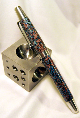

Well here is my second attempt at going kitless. Again I used aluminum (I really like the weight) and polymer clay. The nib is a small steel heritage from Lou. I figured out how to polish the aluminum a little better and added a clip.
I have been trying to do Mokume with polymer for years and have never been satisfied with the results. I have always wanted that "Pop" of color and could never find it. Finally I stumbled upon this method after screwing up a few other pieces. I was blown away by the color and contrast.
Thanks for looking!

Beautiful Keith . I love the look . Glad to see your perfecting your finish and you got your clip problem worked out , threaded ?
I found a finish I'm going to test and see how it works , I'm waiting for it to arrive . From what they tell mne it sounds like it might just be what we are looking for . It puts on an ultra thin coat , 2 to 3 microns thick and is chip , scratch and wear resistant . It's not Epoxy but is a solvent based finish . I'll keep you updated .

Keith!! LOVE IT!! That blue with the copper color really POP!!!
Funny thing about Mokume Gane I feel the same way. I havent really found a technique that I liked that didnt result in heaps of scraps. Very nicely done!!

Butch, I am all ears. It almost sounds to good to be true, but I will keep my fingers crossed. The polish that I used helps with finger prints, but it would be great to find something to help with wear. I use the faux leather one I posted everyday and it hasn't turned anything black or rotted my finger off yet:wink:!

Toni, MG has frustrated me for years. This one I had very few scraps and it was built right on the pen so no seems. When I started slicing away at this one I got so excited I stayed up until midnight just to get a picture up.

Thanks Skip. I was really trying to stay simple so I didn't distract from the clay. My intentions for going kitless was to find a better canvas to highlight the clay and the colors you could achieve with it. Thanks again for looking!

That is one of the most beautiful pens I have ever seen. I collect very nice fountain pens. I attempt to make some myself :rolleyes:. But this beats them all. I LOVE THIS PEN !! You and Toni should design stuff together. You are both so talented. The photography is excellent too!!! Regards, Wizard

That is a spectacular piece of work! My only tiny constructive criticism would be that it looks a little long for my tastes. Otherwise, the clay work is stunning, and the styling is very classy!
Your criticism is alright by me. If we were all the same it would be a boring site. The pen is 6" capped. Nib tip to end is almost 5.75". It is slightly (.25") longer then my last, but the weight is still very nice.

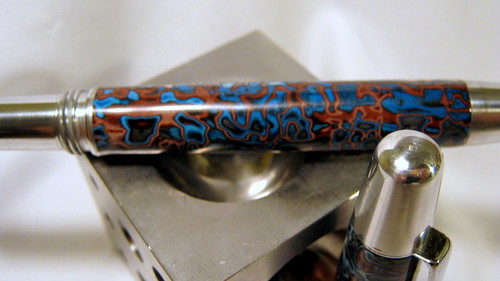

what size thread are you using.
Right now I am using a .5" x 20. It is what I had and I didn't want to invest in a bunch of taps in the begining. I am going to start experimenting a little now that I know the basic size I am going for.

Stunning!!!! Great work Keith! I like it all from top to bottom. Your efforts and hard work really show. I hope to see this one on the Home Page!

Thanks Mike. This one is a little longer then the first one I made. The first cap I made was all one piece. The top finial on this on is threaded so I can put a clip on it. I made it a little longer in case I screwed up (which I do often). For the next one I will go back to the original size which is about .25" shorter then the bottom finial.

Looks Awesome Keith. I love the entire pen. I don't know if it's Mokume..but who cares! Get some Aluminum Polish over at Belle Tire..it's like $5 for a jar and lasts forever. That polish will amaze you.

Thanks Jeff. It's layered and manipulated much like that of metal mokume gane. Making it out of polymer we tend to get a little crazy with our colors. The mothers polish works really well. The funny part was I didn't even see the scratches until I polished and took the photo. The mirror finish shows everything. Napa had about 10 different aluminum polishes so I went with what they recommended. I also got some Brasso which didn't do a darn thing for me.

Now that is one stunning looking pen. I really like the polymer clay contrast with the Aluminum. Nice threading job too. Thanks for posting this.

It's a tough pen to critique. I love everything about it, the blank, the finish, the styling and shape and proportions. I don't even think it looks too scratchy really. Finally..spotted something...you have a little nipple dimple on the very center top of the cap. Better just send that to me to fix and store away and you start practicing again. :wink::biggrin:

Nipple dimple...that's great. There is a small indentation in the top and I actually left it there intentionally. I turn and file most of it off at the end, but for some odd reason I like the look of the small indentation. It's almost like a signature for me...I know it sounds weird.......but a little nipple is good...nipple dimple that is!
