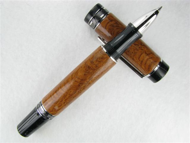

This one is done in Australian Lacewood.

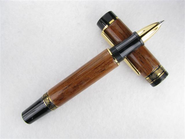

This one is done in Australian Silky Oak.
Both were finished with 6 coats of thin CA applied with a Q-tip. Each were mm'd at 4000 between coats, then to 12,000 after the final coat was applied.

Both look great! I was wondering if there was something wrong with my
computer, no pictures were showing up.
Have to log in .. oops! :redface:
I like the bands on that kit, too. Where do they come from?

Hi Charlie; The kits came from CS USA.
Nobodies commenting on the prices though!

Nice looking pens. There is a CS USA group buy going on right now with these kits on the list. Mike, your prices are very reasonable and should sell quickly.

Very nice pens. This kit is new to me...I like it a lot, and will try it myself soon. The barrels are also very nice...the figure is interesting. Your photos are also great. So good in fact, that it looks like you did not get the diameter of the barrels down to that of the hardware (minor flaw, but a place to improve). All in all, very nice pens. I will strive to do as well.

Hi Steve; Your comments are well taken. There is a reason, in my mind at least, for not taking the wood down to the diameter of the barrels etc. If I had done so, the wood
remaining on the tubes would be so thin that it made me nervous with respect to it's wearability. (rightly or wrongly, that's my reason, and I'm sticking to it).
As a matter of interest to you, only the most respected of us as penturners would even notice that minor flaw as you put it. To the average consumer it goes unnoticed and really doesn't affect the operation of the pen in any way!:)
