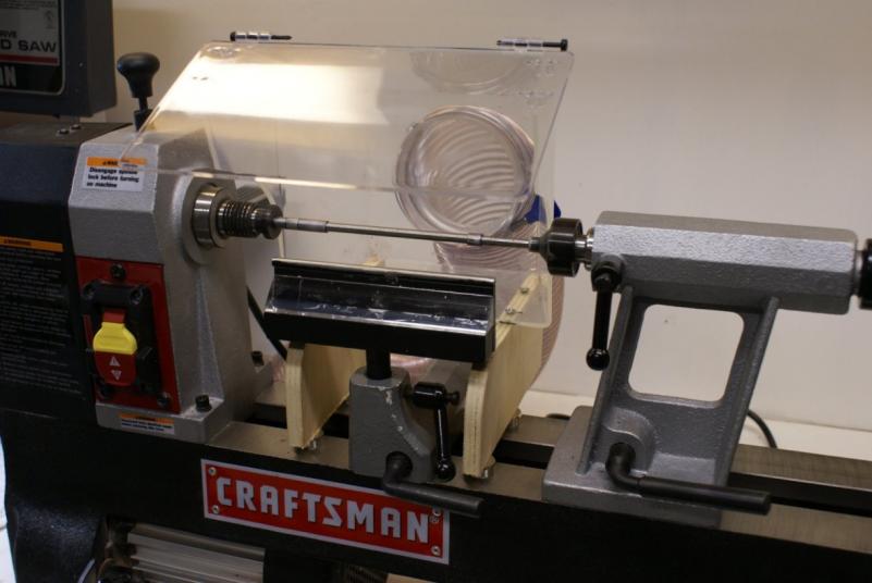

I have the Craftsman MiDi lathe ..it has a MT2...
