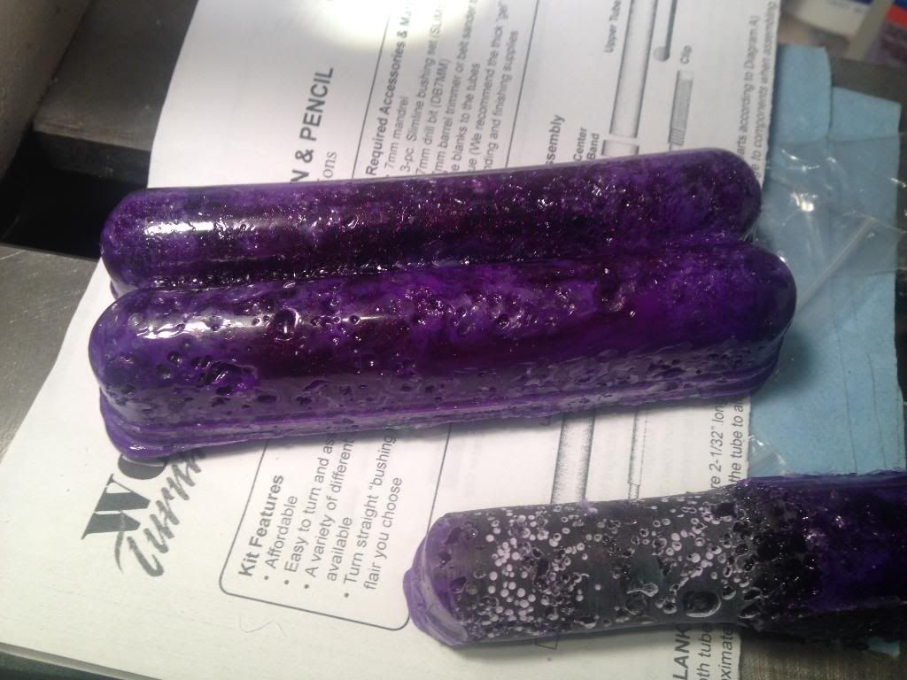

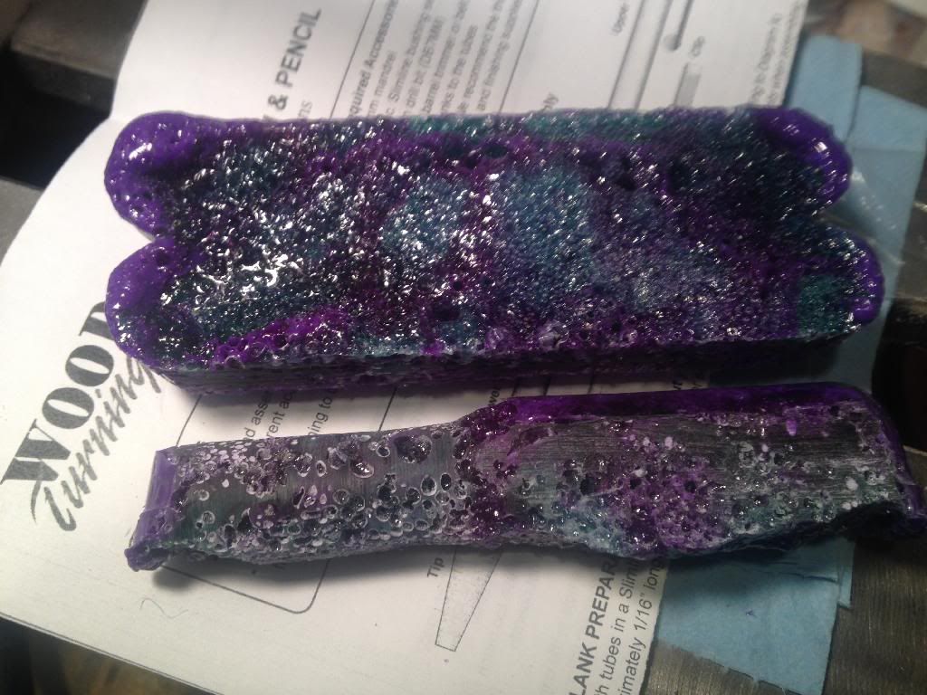

As promised earlier, here is my real first cast done under vacuum. As you can see, the bubbles are far more prominent towards the flat side (top) of the slab. The pour was a Mardi Gras theme purple with gold Pearl Ex swirled with green sprinkled with silver Pearl Ex. I didn't actually polish any as there wasn't really much to polish. I'm going to save it and maybe hit it with some other color under pressure to try filling the voids.

That's an impressive collection of air bubbles! :)
If pressure casting works to fill the voids, please post a follow up...

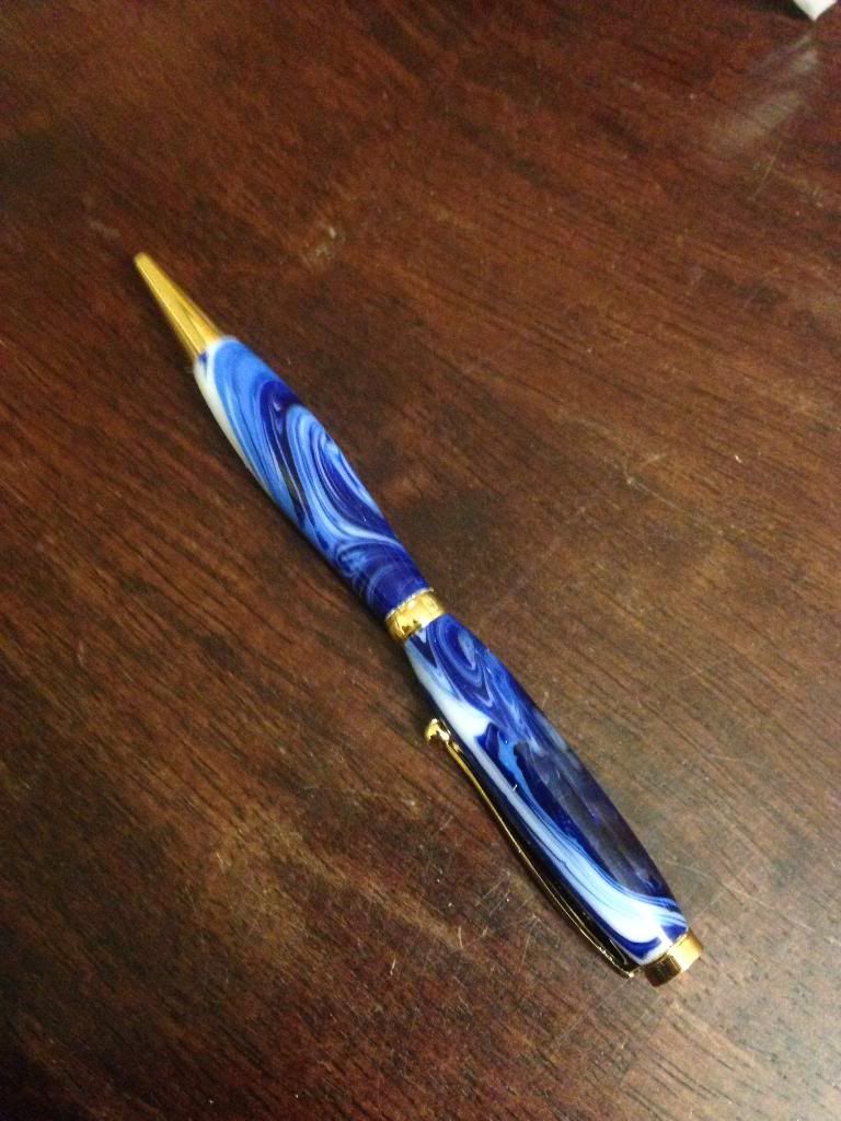

I turned a pen from a blank sliced out of the second block I'd cast. The material turned very nicely (after all, it is Alumilite!). I only have a lame phone photo of the results so posting a picture will have to wait a bit (hopefully later this week).
I'm pleased with how the material turns and how the blank came out. It's not commercial grade swirly bliss, but it's not bad for only the second block I've made.
Cmiles1985
Nov 12, 2013
1,611
Aransas Pass, TX
I can't wait to see what you've turned from your castings. It sounds like you're getting it figured out pretty well. After my foiled attempt at vacuum, I got pretty well situated through only a couple more trials...then my Alumilite set for a while. I attempted a burnt orange/white cast for a custom and Part B was semi solid. I (stupidly) thought that was probably the end of the road for it, but I made the cast anyways. The color came out spot-on. However, do to the viscosity of Part B, a complete mix did not happen and the cast has some "moist" areas. Then I read to heat up Part B: voila!! It was a low viscosity liquid again, made pour two of burnt orange/white with the assistance of my two year old son. I guess I was sidetracked and spilled about half of my mold on the garage floor! So, I gave it one more shot, and the third try was a charm. All of this was to make a custom FP for my mother to give her boss on his birthday. I told her I was only about $50 in on making the blank, but I'm sure I can recoup most of my expenditures :)
Good luck using the volume calculations on the Alumilite site. They show cubic inches *0.554 = oz of resin. My mold comes out to 13.7 oz based on that...I pour 17 oz and get a perfect slab.

Ouch! So far all of my spills have been fairly small.
My Side B was gelled last night as well. Soaked it in very hot water for about 45 minutes (changing the water multiple times to keep it hot). Thought it was liquify enough, but it started thickening up a bit.
Stirring the two together was "interesting". I put down the spatula that I'd normally stir with (much too wide for aggressive stirring) and used a pair of Starbucks stir sticks...that let me really go at it and the semi-snot-like Side B mixed in fairly well.
I haven't seen any problems on the outside of the blank, but haven't cut into it yet (so there may be problems deeper in). While that block sat in the pressure pot, the rest of Side B went back into hot water...another hour of soaking and it appears to have stayed liquidy this time.
One more small block to cast today...after I get some more mixing cups (oops).
I haven't tried the volume calculations on Alumilite's site. Easier to just wing it apparently.
Any pics of the burnt orange and white pen?

I have not yet made the pen. I'll be epoxy in tubes in tonight. I'll post a pic of the blanks though. My Part B stayed fairly fluid after one good long soak with just hot tap water (~140F). I poured some Green Bay (maybe-not) Packers colored blanks this morning for a new repeat customer. The B side still poured very freely.
As for the oops slab, it was very noticeable that the parts didn't thoroughly mix! The outside of the slab is very sticky and nasty. I still cut it into blanks to see what happens (<---too tight to throw away resin!!), and I'm going to forget about them for a few days/weeks and see if they dry out.
