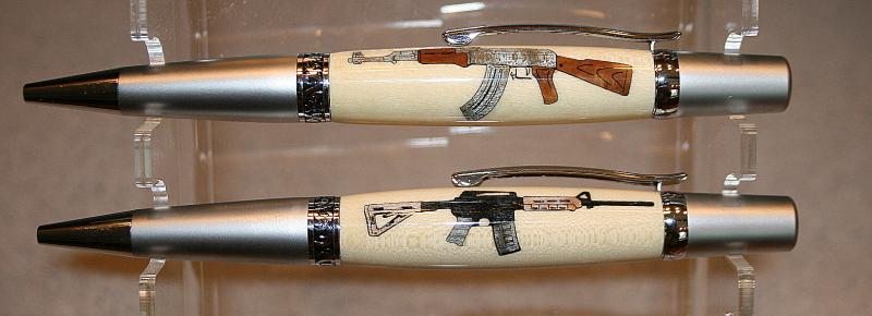

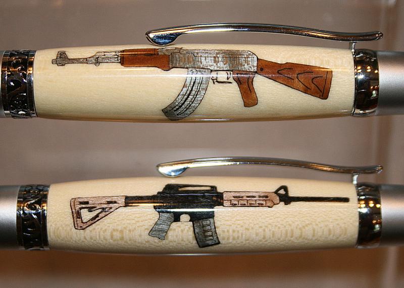

2 pens finished with the new ca finish...
Here are 2 laser cut kits that I finished with the new process. To answer a couple of questions, this can be sanded with micro mesh. It leaves a finish with the polish that has to be taken into direct sunlight to tell any difference. Hope this helps clear up any problems. I also know Rockler has been approached with this product and they may be bringing it to their stores as well. IMG_2658.jpg
