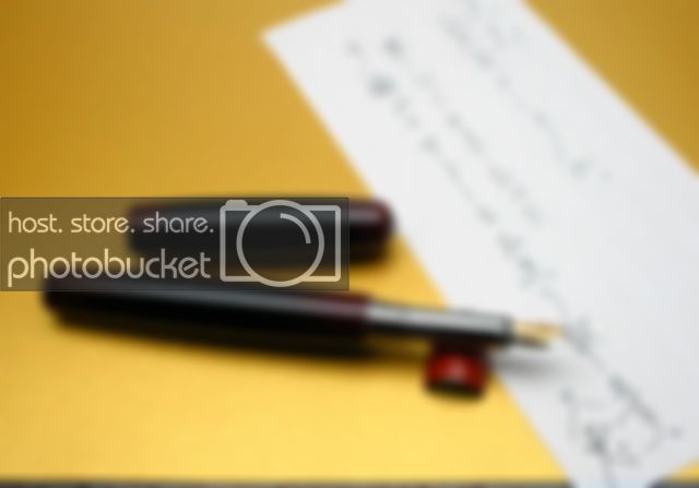

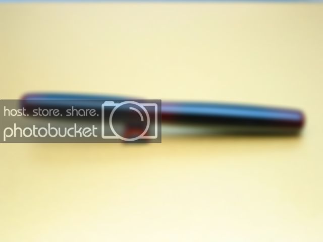

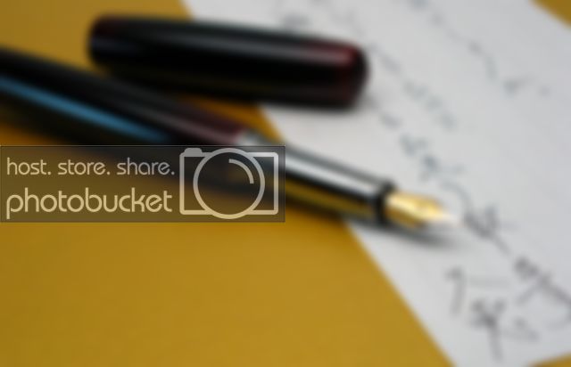

Hey Folks, I know you must be getting tired of all my babbling on about urushi :rolleyes: but this one came out quite nice and just thought I'd share. It's the same color pattern as the last one but I changed the shape a bit and made it a FP. The base is hard maple and then 4 different colors of urushi applied over 12 layers. I finished it with magnolia sumi and micro mesh/olive oil which seems to work just as well as powdered deer horn. It's a challenge but I'm slowly getting there. Tell me what you think.
Cheers, Chris

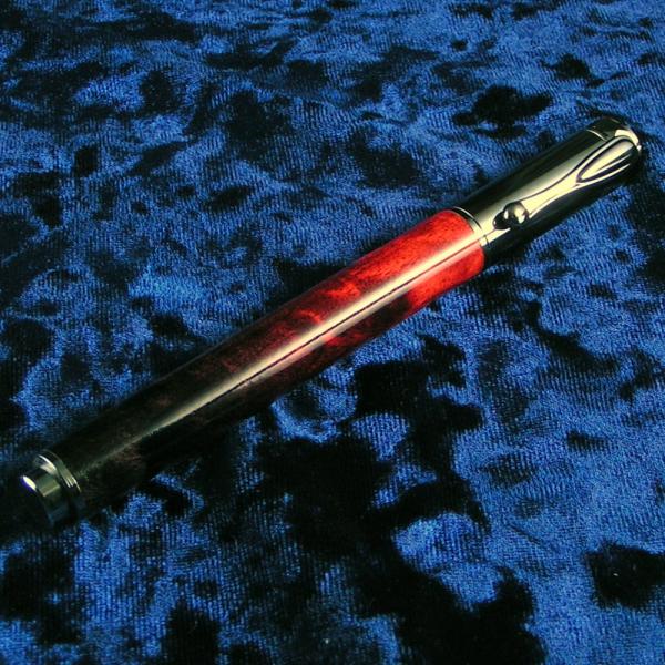

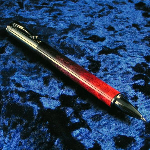

Not too shabby Chris....it looks like you're starting to really get it down. Personally, I'm a huge fan of the black fading to red....I did my own pen with that same type of color effect (though it doesn't look nearly as good as that!!). You should write up a tutorial on urushi!!:hammer:
Ya, it's coming along. Actually, the next few I do are going to be red with maybe a fade to black. Nice looking fade you made BTW! Maybe I'll try to break out the camera next time.

That's really cool. what colors did you use to make that??
There's a brown-ish base mixed with tonoko powder which fills the grain. That's leveled and a red-orange over that. Then black with a fade into the red. It's topped off with a semi clear tinted with a drop of black. The clear tint was airbrushed.
