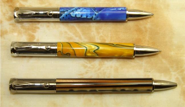

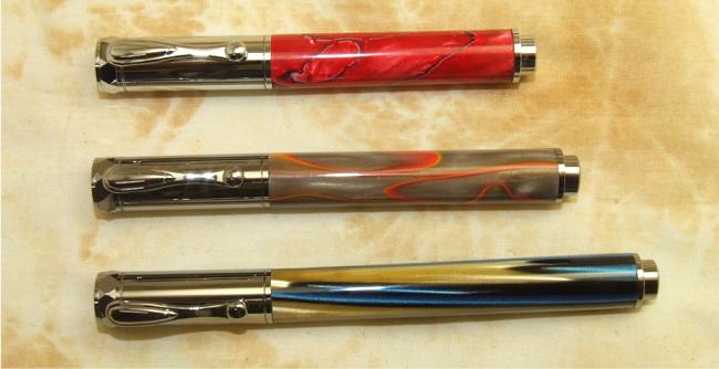

Here are some shorten Zen pens. Springs were removed from the shorten version and tubes cut to exact measuremnts.
Mini- Fisher refill- tube length-2.240
Midi- Parker style refill-tube length 2.650
Maxi- As is from kit-3.350
Very nice group of pens.
This is a good example of what you can do with the same kit by making some modifications.
I think I like the middle length best.
Thanks for sharing these with us.
Anthony-
nice pens and many thanks for posting the sizes. I like the options better than the original kit. Particularly like the balance in the midi.
Jon

I think I like the midi and mini. Both look really nice. I have made one of the standards, and was thinking about trying a shortened version. Thanks for figuring it out.
Beautiful pens Anthony. I am one of the few that actually likes the pen style. The midi and the maxi are my favs, but I prefer the Maxi. BTW good job on the pens!
