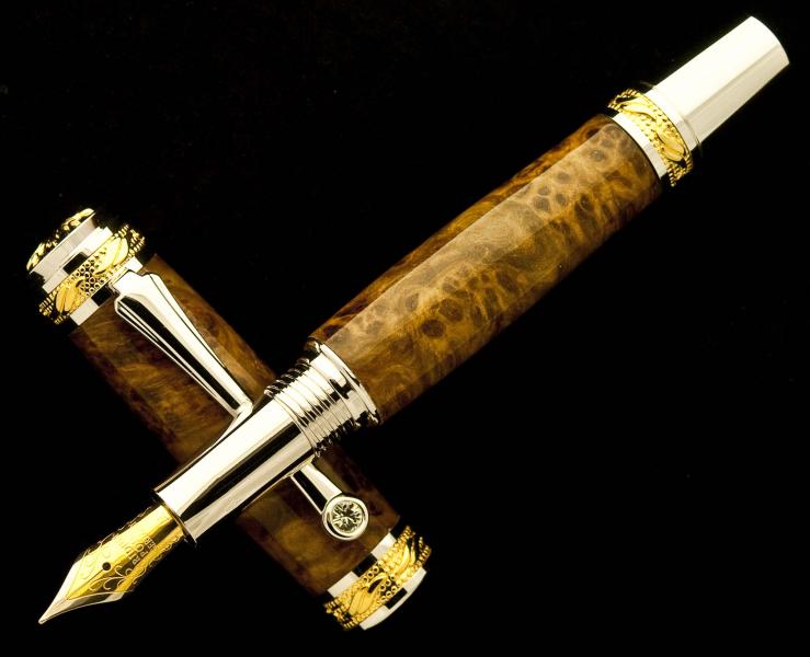

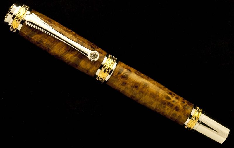

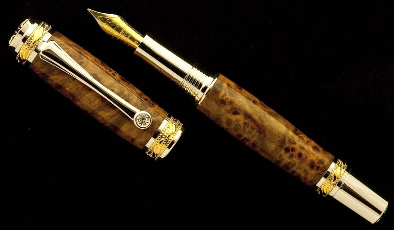

Made it this A.M. It's Yorrel Burl on a 22K/Rhodium Majestic Fountain Pen. Enjoyed making it. Comments welcome but most of all thanks for just looking.
I hope everyone has a great weekend! Doc:smile:

Very nice! Never heard of that wood before. Looks great on there though. Your finish is so shinny and the fit spot on. You make some of the nicest pens I look at on here.
Gorgeous finish Doc!!! Love the color tones in the Yorrel Burl and the gold accents set it off beautifully. A very manly pen indeed!! :tongue:
Looks like a CA finish???
Dawn, It is a CA finish. 2 coats of thin CA, 8 coats of medium CA, MM (wet) to 12000 grit and then HUT plastic polish. Doc
WOWEEE! That is beautiful. Great work Doc. I have a couple of these blanks if I remember right, I will have to try one out.
