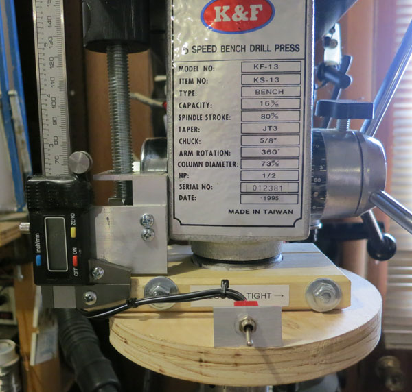

(1) DIY depth stop with digital depth gauge

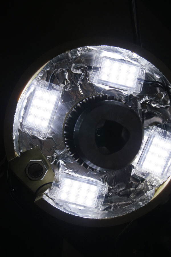

(2) DIY Quill-mounted Ring Light (Walmart truck bed accessory lighting)

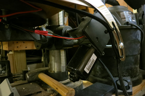

(3) Motorized table lift (Junkyard '92 GMC truck wiper motor, '64 Chevelle alternator bracket)
