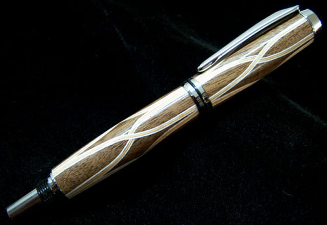

I so admire the Double Wave and that sort of design that I have seen some of you post. Great job to you, I love them!!! So, trying to move in that direction, this is the end result. No, it's certainly not perfect, but I do like the way that it came out. The blank is Walnut with Veneers. CA finish.
Thanks for lookin'. Any thoughts are welcome and appreciated.

Very cool! Is there a tutorial or pics coming soon to show your cutting/laminating steps? Way to go, I love it!
Very nice 1st try. I think you will work out a very cool version of your own once you get the knack of it... However, I think you are doing 'laminations' not 'inlays'? If thats the case you're going to have a tough time replicating the weave that works no matter what. (I've seen some of eagles in person, and I don't have a CLUE how he did it, but for the repeat pattern to work, I think it has to be inlaid).
I agree. You are right, this is a lamination. I do have a way that I want to try for the inlay, just haven't gotten around to it yet. I am happy with the lam results even though I know they need fixin'.

Steve, your design is offset because the saw kerf is not matched to the insert thickness. Basically, what you remove with the blade you need to replace with no more or no less of the insert.
I'm guessing your blade is about 0.025" and the thickness of three pieces of veneer is around 0.060". That difference is causing your design to be offset. The more cuts that you make the bigger the offset will be as in effect the blank is "growing" by 0.035" with each cut and lamination.
