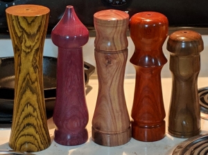

I made these pepper mills for my family. They are my first non-pen turning projects. My goal was to make each one unique. I did the walnut first, which is why it is so much shorter, I made lots of mistakes. I had to acquire, 75mm jaws and a parting tool to complete these. All I had before was 50mm and 100mm, and what I really need is something between 75mm and 100mm so I can cut a tenon on a 3x3 blank that fits with the jaws nearly closed. Also, any tips for cutting tenons with only a parting tool, and carbides (4" radius square, round, and detailer from yufutol)? I found myself guessing at the angle which obviously lowered my confidence that the blank would hold. I did have one of the blanks pop out on me, which hurt.

You did a good job in your learning process.. I don't see anything wrong with any of them... as a regular pepper mill turner, may I offer a couple of suggestions... not in your design, those are spot on... but maybe in technique that will help a little...;. I pretty much only do the crush grind and the little 4" and 6" crank operated... I don't do the standard mills with the knob on top at all...
Yours all look like the crush grind, so these comments may help.

Chuck, those are beautiful pepper mills !!!
Thank you. They are my very first mills and I was winging it mostly on shape. The only one I was sure of the shape was the bocote, it just seemed a shame to do anything to draw the eye away from the amazing grain pattern. I welcome the suggestions from Chuck, I'm sure my technique is *not* good and I really appreciate the detailed tips and suggestions.
