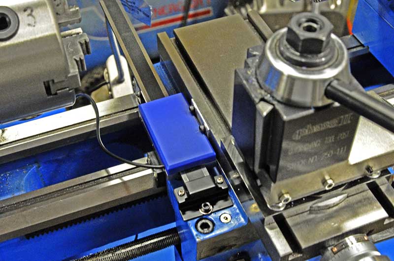

O.K. I'll never mind! :eek: You had me wondering. I'm in the process, now, of making the bracket to attach to the cross slide. I'll send pics when I finish, if it works out.

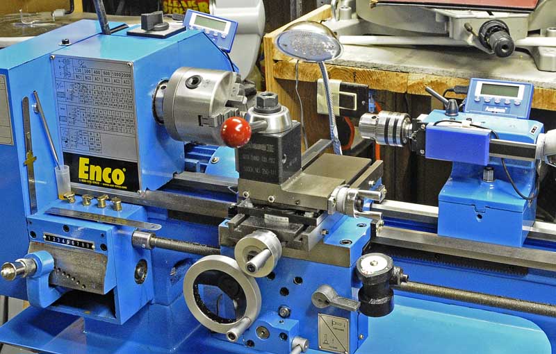

Got them mounted
Here they are guys. DROs on tailstock and crosslide!

Joe,
Looks great. Anything special to look out for when doing the cross slide install, other than making sure its fits well?

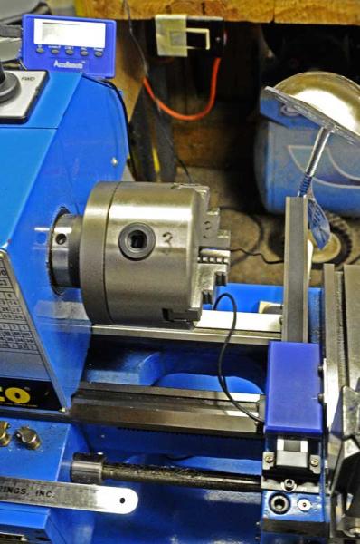

No, I just made a bracket to fit on the bottom of the reader, and as you can see, there isn't much sticking up, in order to stay even with the top of the slide. I drilled and taped for 6X32
Looks nice, clean and straightforward. No clearance issues under the chuck when the jaws are open? You also might want to think about some kind of cover. If oil or swarf get on the scale and in the reader, it's not going to work for long.

Mike: I think the only time I will have clearance issues is if and when I use the four jaw chuck. And THANKS for the heads up on the cover.

Very simple, yet effective design. I like it! I may have to look into doing something similar on mine. Nice Enco lathe by the way, I really like the blue and the blue dro's

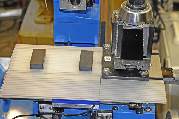

Chuck, I wasn't referring to the display. I meant a cover over the scale and reader. Where it's mounted there in the front of the crosslide, is where a lot of crap falls while working on the lathe.
Joe, the cover can be something as simple as aluminum roof flashing. It's not real high tech looking. But it's simple to bend, doesn't take up a lot of room and it's light so it can be held on with something as simple as a couple magnets. That way you don't have to drill and tap a bunch of holes to hold it on. The magnets also makes things simple when you find your first cover design runs into something or another and you have to re-do it:biggrin:

Mike: I guess great minds DO run together!!:eek: I made it last night. Only difference, I had a piece of corrugated plastic that I used instead of the roof flashing. I have problems with "sharp edges" ! :mad: The magnets also allow for quick removal for cleaning !See pic!
