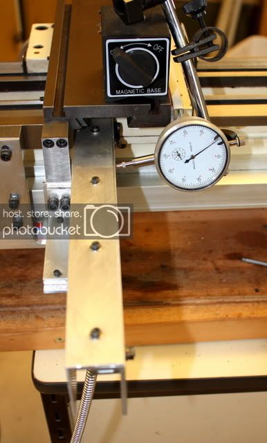

George, one of the things I did wit hthe glass scales on my lathe was lining them up with a dial indicator to make sure that they run true. Whilst it shouldn't be as critical with these, it still wouldn't be a bad idea to check alignment like this with yours.
