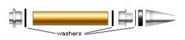

Find the difference in the barrel lengths and then make some plastic/pick guard washers. The washers can go each end of the barrel before you press in the nib and transmission holder.
My cigar kits also have a nib that can be unscrewed apart, a washer can be added here as well. My kits have a tube difference of 5/32" (4mm). I'd make 2 washers 2/32" and another of 1/32".
