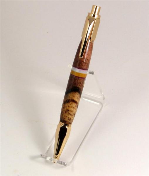

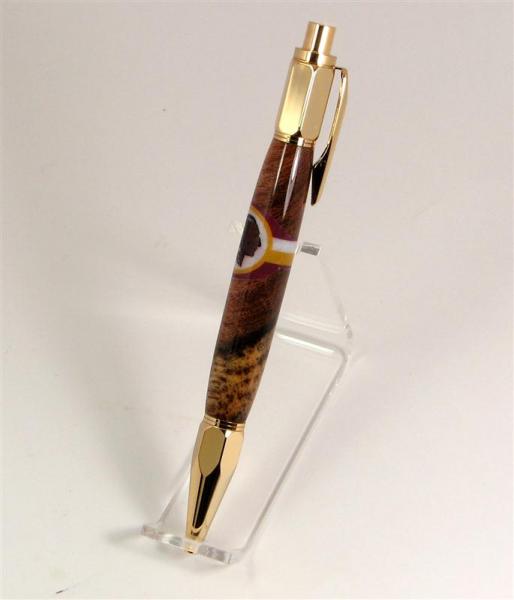

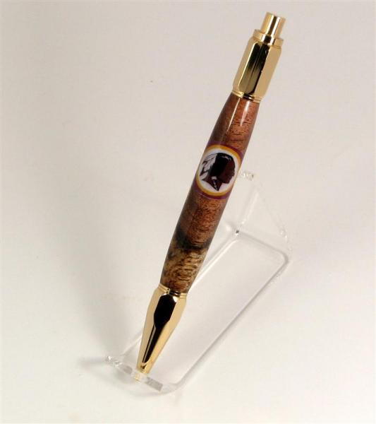

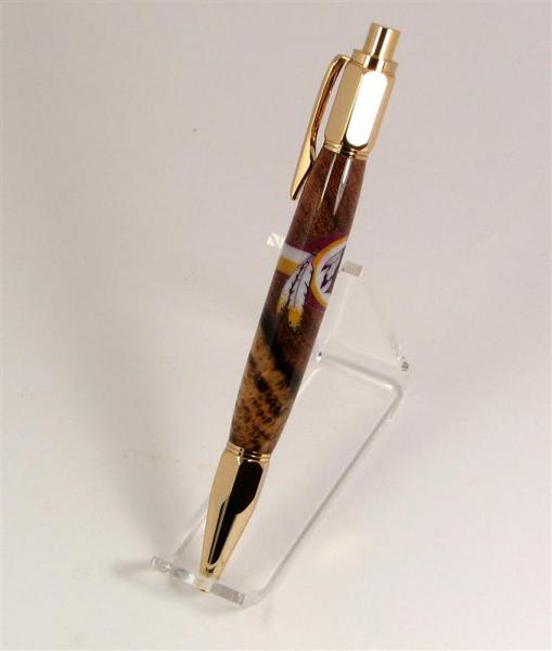

So the customer wanted a cigar band look to the logo, so off to photoshop to take the Redskins logo and add a band to it.
I really don't like using white background decal paper as some always seems to peek out no matter how much you trim, but the customer was VERY happy with it so I guess it's just me seeing the flaws in my own work.
Need a printer that prints white so I can use clear background labels and still get respectable color. :frown:
The blank is mesquite on a gold vertex click.

still working on how to perfect that seam. That one is a bit overlapped so you can see the bold colors stand out where it is doubled up.
The biggest issue was there was a slight taper still on that portion of the pen, so the decal didn't want to lay flat and wanted to bubble a bit up top. I got everything smoothed out but ended up higher than when I initially trimmed it, so the pen body was a touch narrower, hence the overlap. I chose to run with that as the lesser of the evils since I got the bubbles worked out of the front side.
I know now to plan my turning a little better for exactly this and not taper until I'm past the point where the wrap will go.
