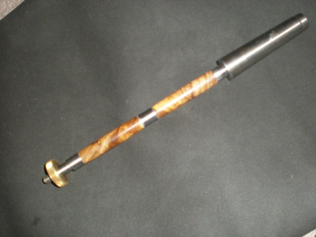

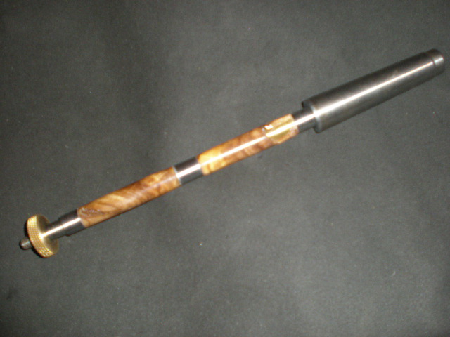

This woulda been my first pen made from some found olive wood. It coulda been a very nice pen that I had planned on giving my old boss for Christmas. But, I shoulda waited until I made that trip two blocks away from my house to the hobby store to get a new bottle of thin CA. Getting real close to the final size, then the dreaded shaking started...I stopped the lathe to find a 1/2" section of wood missing near the end of the blank. A little too big to recover from. And it was totally preventable because I had filled the small crack that had been there before with thick CA, but it didn't penetrate far enough to prevent catastrophe. Se La Vi.

Thanks for the offer JayDevin. I work driving around town and come across great finds every once in a while. This was one, but I have 17 more blanks from that same crotch. The other side is already promised to someone. I picked the least intact one to try to turn as I wanted to save the more intact ones for the Lumberjocks Pentrade that should be coming my way soon.
And I hadn't thought of adding a piece...hum, might just work....and I have nothing to loose cuz I have to order new tubes anyways. Thanks for that idea oldcaptainrusty.
If you turn off the broken piece and add another you could insert a piece of pickguard in between and make it look like a part of the design. If you glue it back together once it has dried you can open the crack and do an inlay in the crack which would also look could. It adds character to the design. You can use either embossing material, ground stone, brass filings, copper filings, or even a wood
dust. Good luck
Wow, another great idea. The other side has a small void that is a little too large for CA but was small enough to hide under the clip. but now I can show it off. One quick question, is pick guard material any different from guitar pick material? I don't have any pick guard, but I have to take my son's clarinet in for service, so I can get colored picks while I'm there.
Thanks Ron. I guess I can get that at the music store too since they specialize in guitars for bands..and do the school instruments on the side.
Update
Well, I tried to part off the broken part and ended up just parting off the whole thing. I used a blank with less figure, but with good color and made a so-so pen. Nothing spectacular, but still nice because the wood had shades of dark brown, light brown, and a kinda pink. I guess I'll save the crazy stuff until I learn how to stabilize.
