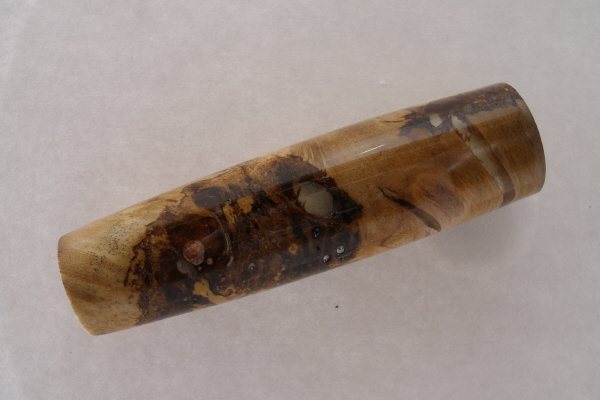

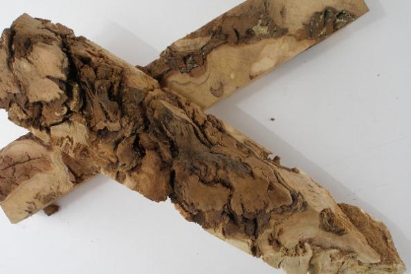

Curtis, you are the bomb. This is exactly what I need to salvage all the Eucalyptus burl I have from my find. If this works, I can save 30 or 40 blanks. My Mr. Fiberglass PR is due tomorrow. I can't wait to give it a try. I hope the PR works as well as the Alumilite. My pressure pot can easily take and hold 60 pounds. Now I'm even more exited.
This is one of the very worst ones, just an example.
<br />
For those not fallowing my other post, here is the first Worthless Wood creation from my shop. It's Euc burl, Mr. Fiberglass PR, 3 drops of MEKP per ounce and held at 60 pounds for about 15 hours. The penetration is complete. All the way to the tube. Keep in mind that the wood is quite punky and has a lot of voids. I also put a quick coat of CA on it to fill a couple of small voids left behind. This could save a "lot" of Euc burl for me. Thanks again Curtis for the tutorial.
<br />
Have no fear, the next set of castings will be done with some sort of color in the resin. This will help to hide the tube. This first set of casting is strictly an experiment. Thats why this one isn't a pen, just practice.
