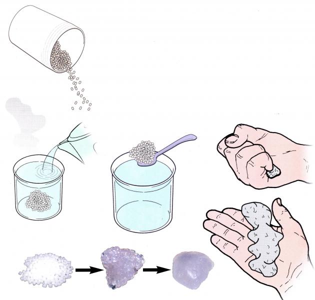

Ive been chewing this compound over for a while and keep putting it to the back of my mind for a rainy day of experimentation but i don't feel i am giving it the attention it deserves so figured i would put it out into the public domain for a bit of brain storming
Polycaprolactone or PCL for short is a type of polyester which ive used for years in prototyping. Generally comes in a granule form, and you pour hot water over it. temps over 60'C turn it from a solid granular state into a malleable state where the granules fuse together forming a putty.
It can then be pressed and squeezed and moulded into anthing you like before it cools, returning back to a strong solid form. When you are bored of it or its served its purpose simply drop it back in the hot water and once again it will return to putty allowing it to be reused.
attachment.php
The stuff is marketed under many brand names.. one of the well known ones is polymorpth.

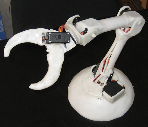

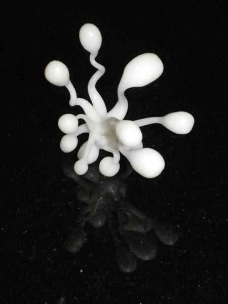

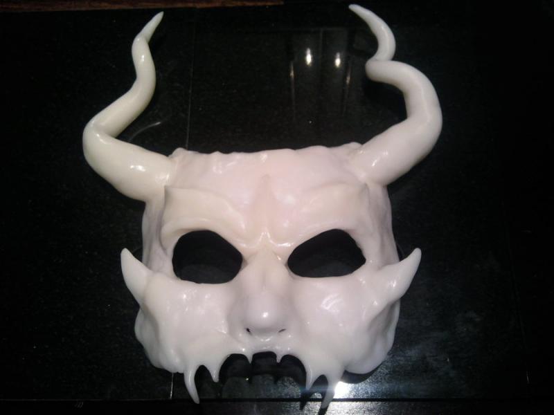

Below are some further pictures of PCL being used by other people, though my line of thinking is to shape it into something eye catching, then chrome or gold plate it. we could create abstract looking pen lids and bodies which do not have to be perfectly round. of course this can be turned down on the lathe too or milled.
Your thoughts? :cool:

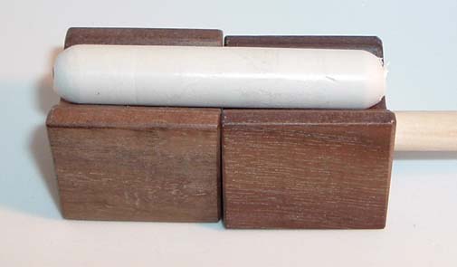

Not sure if this is a type of PCL or something else.
Some time ago I had my hand operated on and they made a brace with velcro straps out of some white sheet stuff that was heated and molded to the shape of my hand and wrist.
I took some of it and put it in about 1" of water and microwaved it until the water boiled. It did not turn clear when heated and stayed the same white color you see here. It did get like real warm putty.
I was able to shape it into a cylinder and it got hard again when it cooled.
It turned OK but I can see no way to finish it. Sanding it doesn't work BTW, it just heats up and makes a mess on the surface.
It was an interesting try though.
I think I'll keep it in mind if I need a knob for something.
