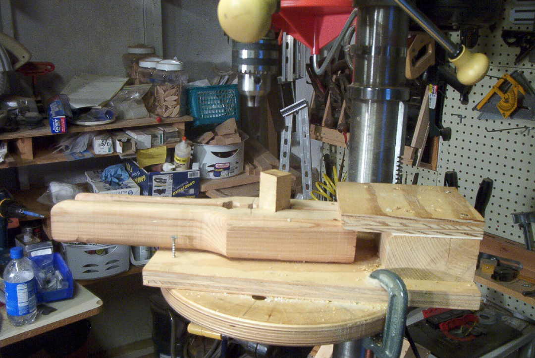

I don't know where I got this tip from, but it works great for my antler blanks. To avoid the problem of not being able to drill the usually non-straight blanks, I take the blanks and turn it round between centers first before drilling. It doesn't have to be perfect, but it makes it real easy to hold in your vice and you know exactly where the center of the blank is then. It also gives you a real good idea of what the color and porasity of the blank is before putting a tube into it.
