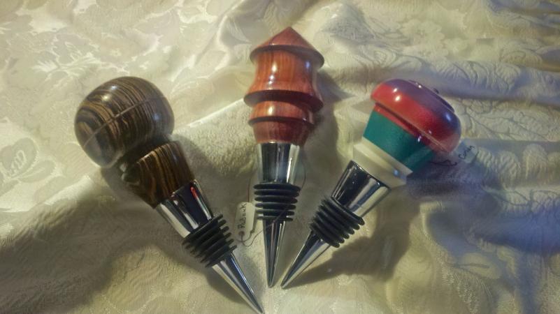

corian bottle stopper
Here is a bottle stopper I did. One on the right

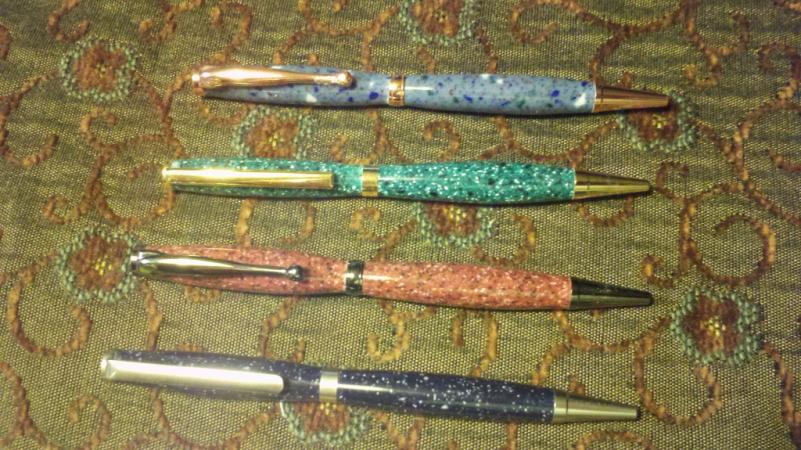

Here are a few pens and pencils that I have made out of corian. Better use only 1 I am having a hard time getting them small...
See the entire pen at. mikespenturningz
