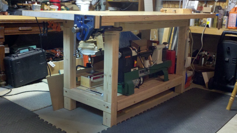

Good vises.........at least two. Here is a pic of mine just after I finished building it.
scaled.php
2 x 4 construction and solid wood door top. Very sturdy and built in a weekend. Plans had options for drawers but I decided the lathe would fit nicely underneath.
Ugh!
You telling me every time you want to turn you got to lift that chunk of iron?
Limited shop space so for now, ya. I make other furniture so I need the workbench. I tend to ready my kits, prep a bunch of blanks and do a bunch of turning for a few days, then move on to the next project.
