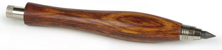

I received my latest goodie box today from CSUSA. Included in the box were the Woodworkers Pencils I had decided to try out. I thought that after reading the instructions it sounded simple enough for a kit with no tube.
The instructions state a few details that I followed. The instructions call for a 1x1x5 blank. Reading deeper into the instructions they ask for the blank to be 4 9/16â€. It also states that I am to treat the end into the wood and use either epoxy or thick CA, so I imagined that I would actually manually thread the hardware into the end, unthread it, apply glue and then rethread.
Things were very different.
I drilled the blank I chose, cutting it back to 4 9/16â€. I then turned it using the bushings provided, turning the writing tip flush to the bushing. I then tried to fit the hard ware and discover two things that I was not pleased with.
First, the turned wood was under diameter to the hardware even though I turned it to the bushing. I used a vernier caliper and measured the hardware diameter, it was 0.495â€, the bushings were measured at 0.453, the instructions called them out as 0.466.
Second, the hardware did not engage the wood, it rattled inside the 10 mm hole. I measured the hole, it was 10.1mm.
Oh there was a third, the instructions called for a blank 4 9/16†long, well the hardware is not long enough to extend out of the end of the pencil body at that length, so I cut the length of the turned pencil, by eye….salvaged the tip by measuring it with calipers and just left it drying in the shop with a healthy application of epoxy on the threads…..I sure hope it engages.
So, any tips from people who have walked this mile ahead of me……what did I do wrong, the instruction sheet is . This was not fun![B)][B)][B)]

Jim, they have finally got the design right in the Sketcher pencil. It has a tube and a threaded bushing which really makes it much easier to make, the right way. Lou was never a fan of the original, I liked it because I sold it, dispite the short comings of the kit. The thing that bothered me is, the new kits that are being sent out are the shorter pencil mechanisms, the same size as the Sketcher. The original kits had longer mechanisms and needed a longer blank and made a nice longer pencil. Why this was changed and no notice given is beyond me. As for your assembly problems, well that was part of the short comings. I have yet to have one returned, but using CA to hold the mechanism in the end, just doesn't seem right, but it does work. I would still buy them and make them if they were longer like the original, but if not, I will stay with the Sketcher oness.

Jim one thing I did for the woodworkers pencil was after I drilled the hole I cut a 10mm tube to fit to length minus the threaded end of the pencil and you have a nice snug fit for the mechanism. I also have a mandrel to fit the inside diameter of the 10 mm tube and made some flush fitting bushes instead.
Darren
The deluxe woodworkers pencil uses two tubes and a center connector. I the woodworkers pencil is the same as the deluxe wood workers pencil. I got extra tubes and use them. I do not especially like center connectors on hte deluxe woodworkers pencil or the PSI 2mm power pencil so assemble the tubes and center connector and grind the brass center fitting down flush with the tubes. The resulting connected tube is 4 inches in both cases. I do put the top hexagonal trim on the top of the deluxe woodworkers pencil. The artist sketch pencil is a little shorter and better fitted with a single threaded tube.
For woodworkers pencil cut the blank to 4 inches and glue in spare tubes. Turn using calipers, and you get a decent pencil. Note that one of the tubes is threaded to hold the pencil clutch mechanism. I have not installed one wrong (yet) but see the potential.

I still am not 100% happy with the hardware fit to the hole diameter drilled, but the brass tube idea will be on my next pencil, as well as using my calipers for sizing.
