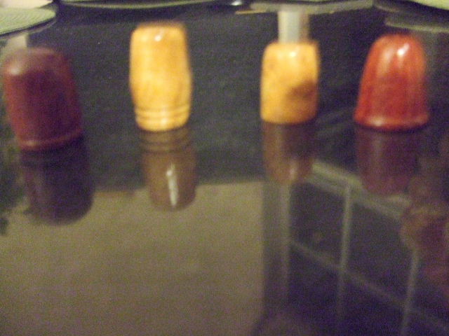

first turned thimbles
here is my frist turning of a few thimbles
they only cost about $150.00
for the collect and the drill bit
what do yall think
sorry for the pic trying new camera

Running thru some older posts and say the comments on the thimbles. I see you are coming the the IAP meeting on the 22nd (meeting is at my place) If possible bring a few thimble with you, I am interested in what info you have on this matter. Look forward to meeting you and all of the others slated that have indicated they are coming.
