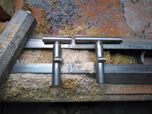

Like you the PenPro is my go to tool so I solved the exact height problem with an automotive hose clamp on each of my tool rest at the height for the PenPro. Any other tool I use I will have to raise the rest, the just drop it down on the hose clamp and ser for the PenPro agai.
