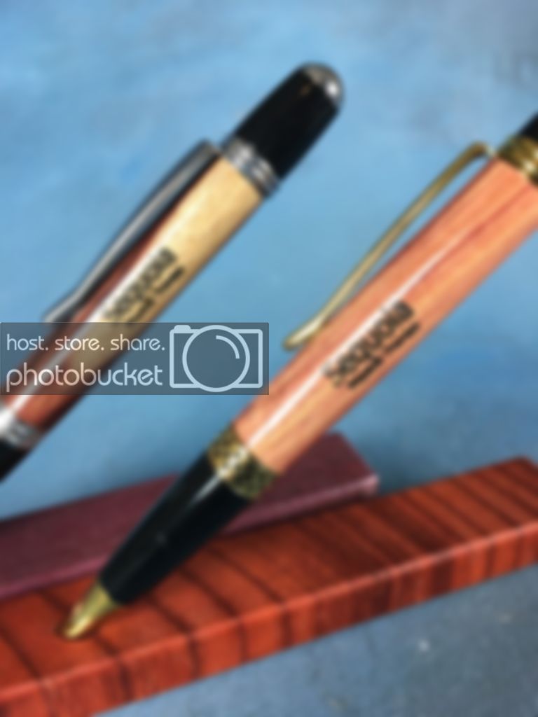

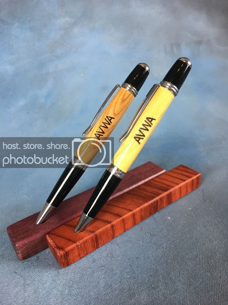

I used the product sold by Woodcraft not Behlens after sanding sealer. I applied six coats of WTF off of the lathe in front of the TV. I sanded with 1000 grit and buffed it using the Beale system using all three buffs and treatment bars. Perhaps not visible is the high shine and extra smooth finish to the touch. I may sell my leftover micromesh pads.
Unknown wood from Cancun and canary wood for my PT place
Yellow heart and Bethlehem olive wood. Antelope Valley Woodturners Association raffle donations.
