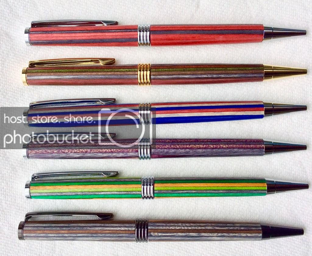

Wood Turners Finish is one method to a tough, shiny, natural finish of your pens. At this time I am recovering from rotator cuff surgery and I needed something I can do now without a lathe. I had several turned spectra ply pen blanks that did not get finished. I had sanded them to 400 grit on the lathe and cleaned them with DNA. I used small blue towels and hand rubbed the thin WTF finish on each tube and let them dry usually overnight. Between each coat I sanded with 1000 grit at first and later 2000 grit by hand. After drying these for 24 hours I hand rubbed them with EEE-Ultrashine using a small blue towel. Final polishing was done with clean blue towel pieces. The video shows the result.

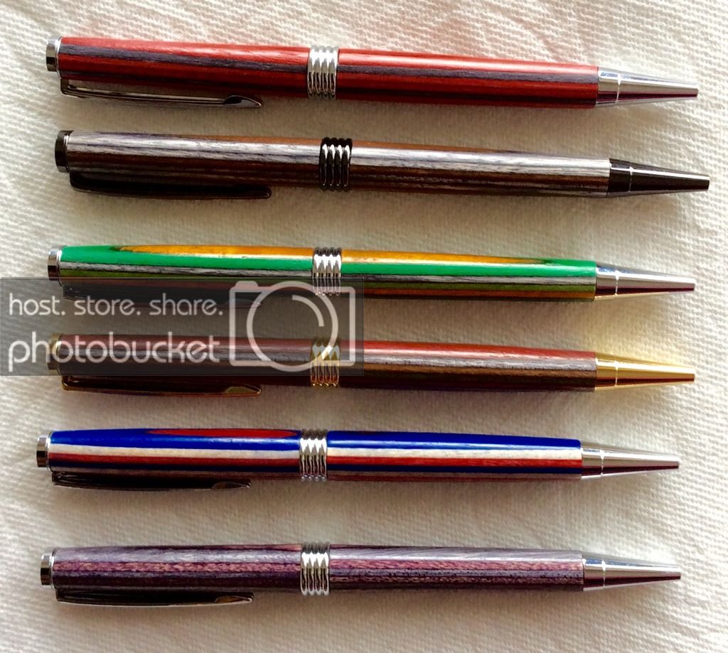

Here are the finished pens. Interesting pressing pens together trying NOT to use my very dominant, injured right arm, but possible. It was also difficult to correctly depict the very decent shine on these pens. Unlike many non-CA finishes, this shine has lasted several days and seems permanent.
The shine is permanent.
