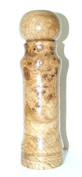

Here is a pepper mill I recently did from an oak burl...

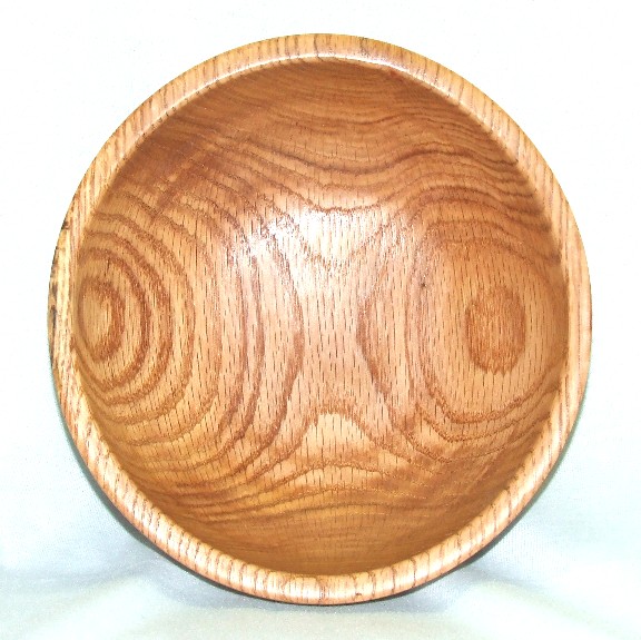

The second picture is a red oak bowl I turned from a tree that fell across the road near me and the farmer that was cutting it was just throwing the wood in the ditch... wish now I had gotten more of it, but we were on our way to town and I didn't want to haul a full load of wood to town and back...

Those are some good looking turnings. I turned some of it into bowl blanks, and some into bottle stopper blanks, and some pen blanks that I would dare to say would rival any pen blank on the internet at this time. They are absolutely GORGEOUS! What are the blank sizes for pepper mills?
E
Pepper Mills work good on 2-1/2 square and close to 12 inches up to 20 depending on what you want for a finished length, I've hear that 6 inch finished mills sell well,
The 2 1/2 size works, but my preference is to start with a 3x3 x whatever length you can get... I like to start with the 12 inch size, but have started with all different sizes... and Ken is right... I do well with the 6 inch mills, although don't do a lot that sized... I usually do 8 to 10 inch sizes and I only use the crush/grind mechanisms.... they are more forgiving on length than the standards with the knurl adjustment on the top of the mill... (I tend to be a little measurementally (or is that mentally) challenged)... CSUSA and Packardwood has about the best pricing on the c/g mechanisms if you buy 10 or more at a time... the regular sizes are with a 10 inch shaft that you can cut to whatever length you need....and CSUSA has just recently come out with an 18" shaft for making the bigger mills. I have two in my inventory now that are almost 14" high...
