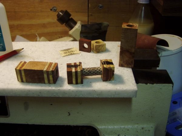

What to do you really want to do? make a laminated blank and glue a piece of resin or PR? or make a laminated blank and cast in PR? I did this one for my last PITH
<br />
laminated blank with sea snake skin ready to be cast in PR.
<br />
Turning was as usual, regarding sanding my fear was about the laminated part especially on wet sanding ( for the PR), I check between each grade of MM to see if the small pieces ( at the nib ) was holding on, after the sanding process I did the CA finish , I'm working on a wood and stone not easy and not much success to drill Opal[:(][xx(]any way hope this help you out.
